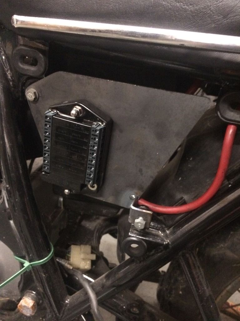

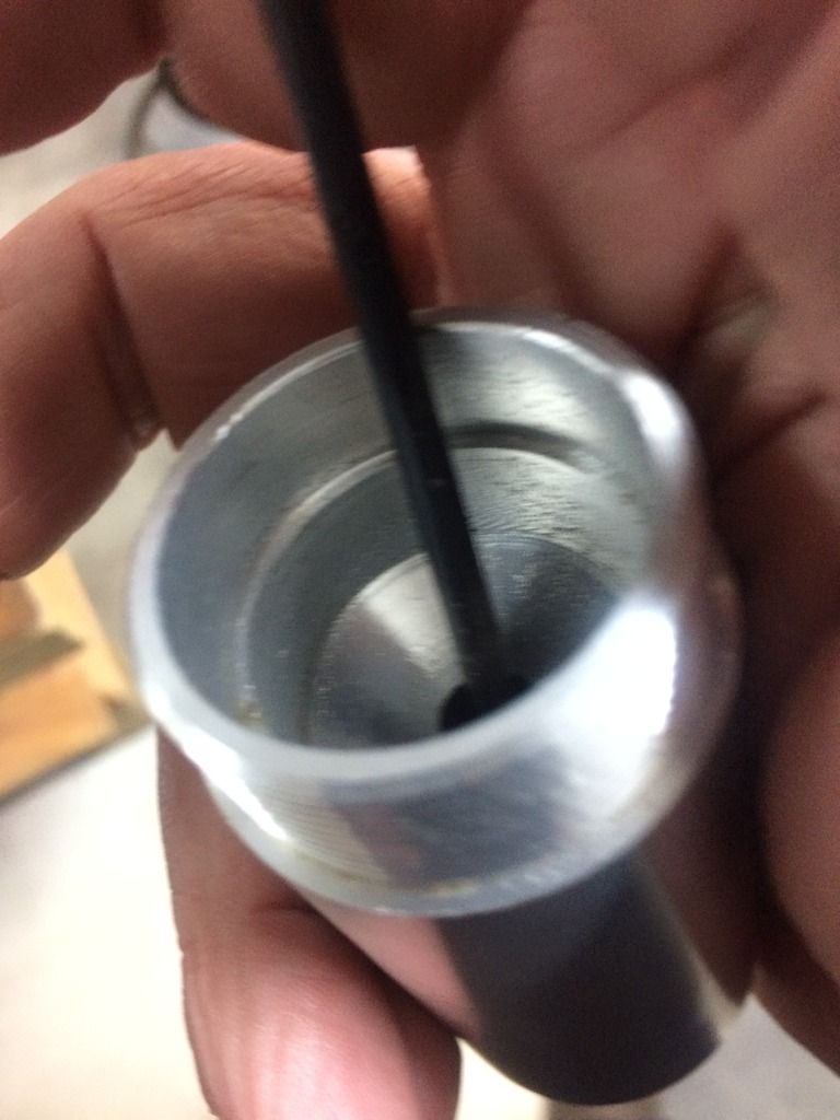

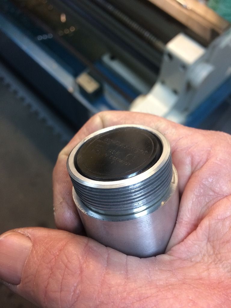

I do have some pics of what's coming though that I can share.
Some might question (I've had this talk with many who have seen my bike in person) why I'm leaving the side covers and everything in the triangles stock instead of moving it all under a solo seat. Well...there's several reasons. I'd like to eventually be able to take some light trips with this bike and see if I enjoy that before considering a second bike like a KTM 690 or a 990 that could handle limited stretches of pavement and days of fire roads. Probably the bigger reason for leaving that area alone is that getting this thing to run up here has been difficult enough and I have zero desire to pull that stock air box and have to address more tuning issues and things would look silly (IMHO) with no side covers and that sitting there. So I wanted all of this Motogadget stuff mounted where the stock electrical components live. I asked Cal if he would be able to help me by coming up with a panel that would do the trick. I don't think this is the finished product but it will give an idea of what we're doing.
We'll also be using the stock bracket off the starter solenoid and mount that solenoid to the right of the M Unit. The R/R will attach to the back side of this panel (towards the rear of the bike). Space is really limited under that cover but I hope this works out.
Next up was where to mount the M Lock. Cal will have to confirm but I think this was the most challenging part. Originally we wanted it under the side cover but we were worried about it reading the fob under there. We talked about drilling some small holes in the cover (just in the area it was mounted to make reading easier but didn't care for that idea. We talked about having it in the bar end but I use bar end mirrors. We also kicked around simply having it mount in the stock location down by the #1 header and that's where we ended up. I love this location and the idea that Cal came up with. It kind of follows the rest of the theme of the bike. Keeping the look of a mostly stock motorcycle (again with the stock seat and side covers and ignition location) but with the use of very modern components. I'm really excited about this piece. I know it took a lot of work and time on Cal's part and I appreciate it and know that I can only pay it forward because he clams up when I suggest I should send him money for his efforts (that's really the only way I can get him).
This piece started off with a solid bar of aluminum (1.5" X 3.25") and ended this way. The wires for the M Lock will pass all the way through it.
The business end looks like this.
We went back and forth a bit on how to attach this to the frame but eventually decided to just drill the body of the aluminum, tap it, and use a 6mm bolt to secure it to the stock tab on the frame. This part will not get touched so I hope it's enough to keep it secure. This piece really keeps with the minimal theme that I've been after and (kind of like the license plate bracket) will appear to just be floating there. The wires will then just travel up the frame to the backbone and then back to the M Unit. We thought about anodizing this black. This would have been really discrete and hidden it but then I thought polishing it (you all know how much I love polishing alloy) would make it stick out a just a bit. For people that know these bikes they will wonder what in the world it is. It will also go nicely with the rest of the polished pieces I have now.
Thanks again for your help Cal.
