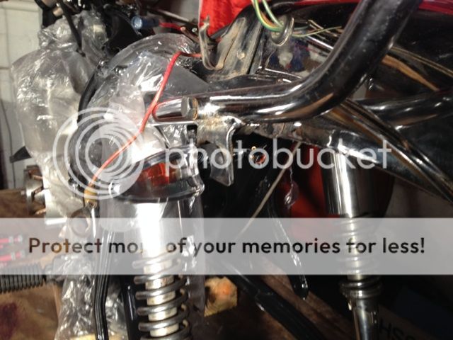

Starting to use some of the parts from DCC.  Ill be down tonight trying to get the handlebar situation done tonight so ill update as it goes on.
Ordered some LED bulbs for my new gauges, installed them as well as gutted the wires and bolts from my previous pair.
Also starting to prep some parts for paint. More to come.
Oh yeah remember that switch incident? Girlfriends dad hooked me up with some small soldering, reheated the original and installed a new wire for me!  No reason this shouldn't work right?? My hands shake way to much for me to do this, now ill reassemble the switch and hope it works!

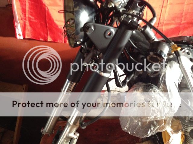

Didn't get the bars put together because of a bolt i can't free up.  But i test fitted them and it seems like something is a little off.  When i set the old bars down in the spot it fits perfectly, but the new bars do not go on as snug. I bolted them down tight, but it almost looks like there is some space still and I am wondering if thats safe!
I really do like the look though!

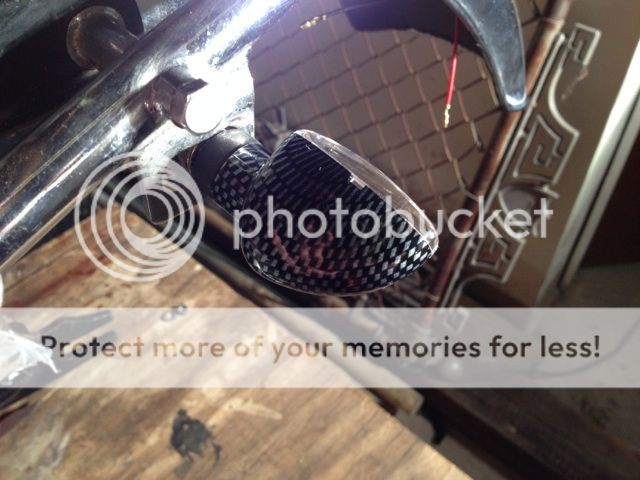

Got the new Taillight installed!  Took some modifying to get it the way I wanted, but it looks good I think!  Only thing is, the old one had 3 wires, and this one has 2.  What should I do here??
Still have some tiding up to do:
Just left with this huge hole, and the old mounts for the last light, I want to cover this up somehow.  I was thinking maybe JB weld over it, and smooth it down? or get a sticker to put over it?

I've got the same tail light. I swapped the tip on the stock ground wire for a crimp on eye tip and connected it to one of the bolts. You don't actually need it though since the tail light grounds through the metal housing. I just added the ground wire to ensure I had good ground.
Offline 2strokeTrush
  • Can you get that back together sonny?
  • Posts: 608
Re: "The Basement Build!" 1973 Cb350F
« Reply #118 on: February 18, 2014, 09:33:48 PM »
Awesome thanks!  I assume black wire on the new Taillight is Ground?

No, the bike doesn't have a ground wire, it grounds through the housing. Me and wowbagger did the same thing, run an eye on the end of the stock green wire to a mount bolt. It is more confidently grounded that way.
The black and red are brake and tail. Ground it, and hook it up. If the running tail is brighter than the brake, switch the black and red around. Brighter is the brake light

Well I'm headed to Tennessee in the morning so I figured i would post this before I leave.
PlastiDiped my fork tubes, and headlight bucket ears, not sure how I feel about it yet,  I didn't want to take the forks off just to paint a few parts, I guess it looks good.
Picked up some small new turn signals, they are carbon fiber look.  Well see how they turn out.
You can't really see them in this picture, but you get it.
