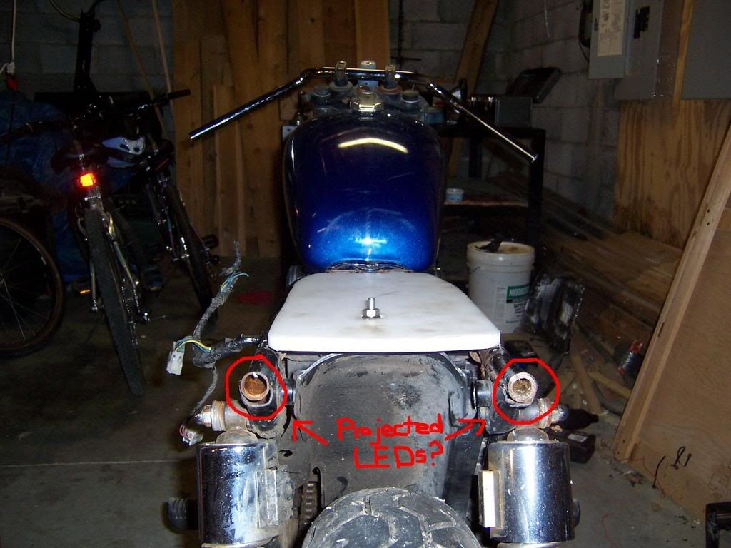

I have been doing some work on the bike and have cut the frame ends under the 'hump' like on the CR750 bikes.
Anywho, I want to mount some tail lights in the frame tubes, like DamnitDan wanted to do here:
http://forums.sohc4.net/index.php?topic=27536.5
I have write-up somewhere on the net of someone doing this to a Yamaha or something which was very helpful, but I haven't been able to find it again now that the time for me to do this has come.
I was hoping someone here could give me some recommendations on dual-filament bulbs and/or sockets that work with the stock CB400F 12v wiring that would fit in the internals of my frame, which is about 17.8mm/0.7 inch. I'm assuming LED would be the way to go giving the vibration and small size.

I did my turn signals this way, not sure about brake lights. Pics below.
1. rounded off a nut to the inside diameter of the tube
2. Used a bolt to drive it in strait (should be snug fit) and epoxied it in place.
3. Center drilled a stainless bolt that would house the LED assembly
4. Pull wires and thread it in.
Hope this helps with ideas.
