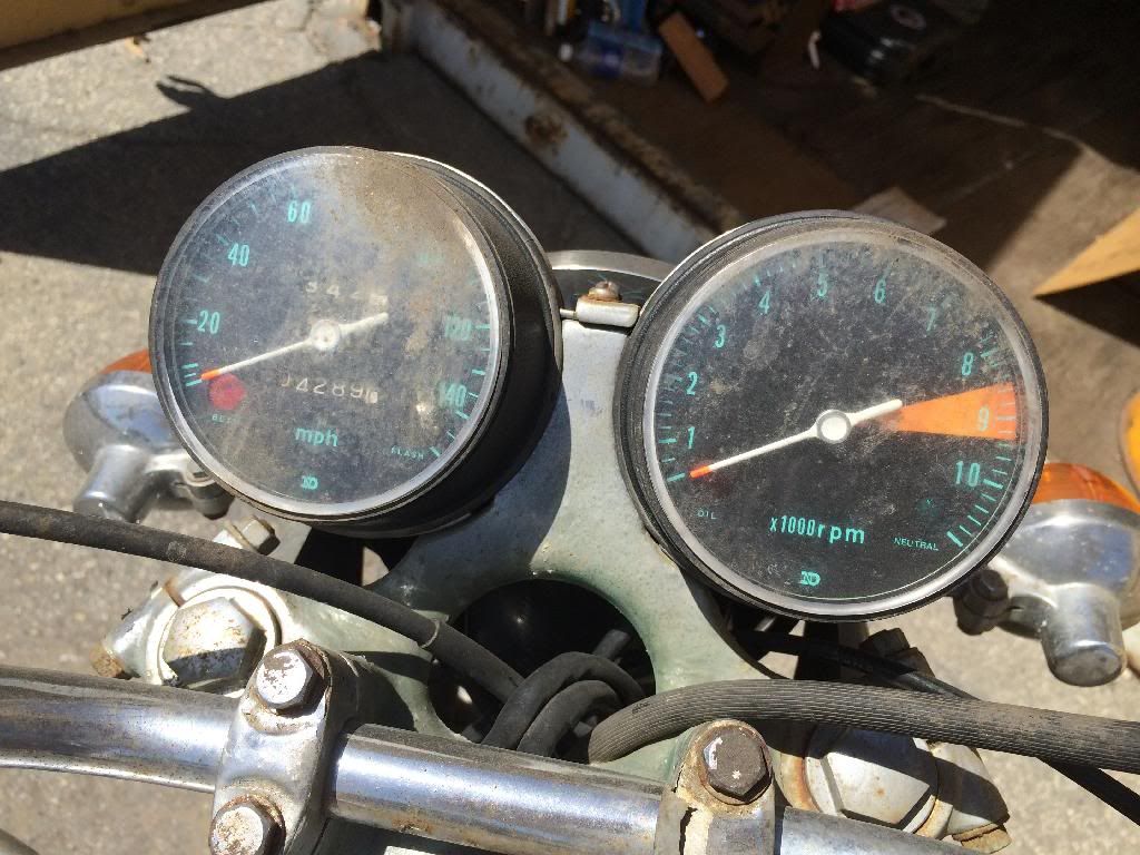

Dang,, I like plastic speedos, .... Got the tach in plastic too.?
Not sure if you were being sarcastic, but will check for you in the morning! :)
Tach housing is plastic, too! I thought they were metal housing.
And here after quick wipe

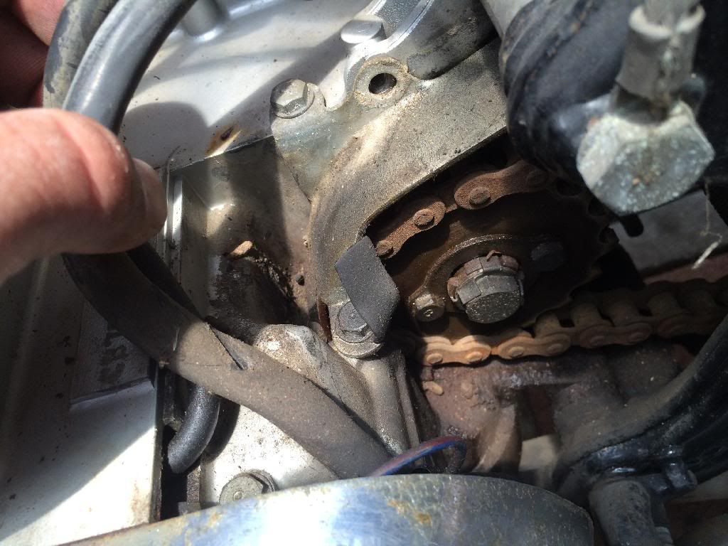

Last test would be to pull the countershaft sprocket cover and look for some chain damage on the case but with those miles sounds like you are probably good. Get rid of that possible stock chain though QUICKLEY if you start driving it    ;)
Looks pretty good down there with another metal chain guard
You did an amazing restore on those gauges.
You are one lucky SOB, Gold Dude, no offence intended!

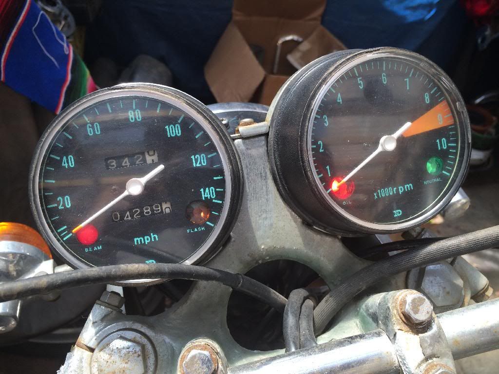

Thanks!
And here's one with lights on, those jewels look so cute!

Nice guages..

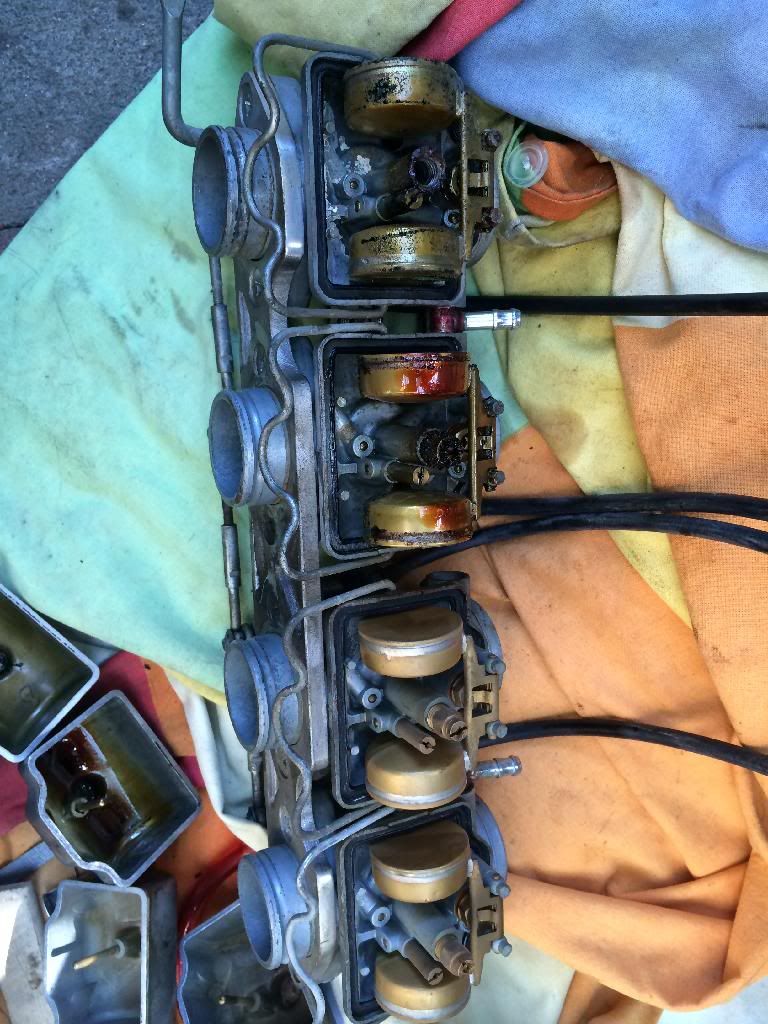

What was the story was it was never ridden?
Bike was parked, last registered back in 1981, so that's a good 30 years, and i think it was attempted, some times between then and now, to get back on the road, but project failed? I opened the carbs earlier this afternoon and #3 and 4 were very clean, but #1 and 2 were totally opposite.
CB550 K0
  • Posts: 35,234
Re: Dammit! It's not a sandcast! But...
« Reply #43 on: April 04, 2014, 09:11:31 PM »
Talk about a half-assed cleaning!
I think what happened was that the carbs were cleaned when parked.  But tank got rusted over the years and got coated. New clear fuel line were installed.  Stuff from the tank got into the carbs, then inline filter were installed, a bit too late.
Anyways, carbs are taking a bath now, should be nice and clean tomorrow

The red sludge in the carbs look like mine old carbs that I parked 1990. The tank has more of it....real led fuel before the unleded green stuff.
