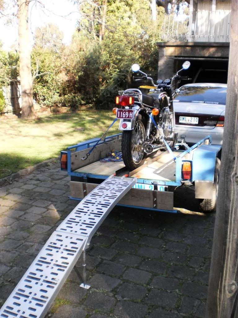

I inherited my father-in-law's trailer.  The base of the tray is made of wooden planks (treated pine).  You lay down the planks, then tack metal strips at the ends to hold them in place.  If/when they start to rot, you grind off the tacks, remove the planks, and replace.  He also made the trailer sides out of (thicker) planks, and made the front and rear sections removable.  The side planks are great, as you can drill plenty of holes for eye bolts.  He was a clever old bugger!
To carry a bike,  I bought a metal channel and placed it on the trailer.  I drilled two holes through the channel and through the planks.  I then welded two bolts to the channel.  I was going to bolt the channel to the trailer when carrying a bike, but it's not really necessary - the channel isn't going anywhere!  You can get the general drift from the following photo:
Cheers

neat ramp,you get that from evil knievil?
Offline Trevor from Warragul
  • Posts: 1,116
Re: build a trailer
« Reply #43 on: September 15, 2014, 02:30:48 AM »
Nope, evilBay Australia.  Gee, a good ramp makes loading a bike so much easier!
