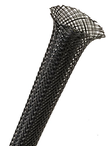

« Reply #46 on: April 19, 2016, 05:35:28 PM »
Nice and clean looking.  Well done.
Although, I personally have developed a deep dislike of that style of split loom and instead switched over to the braided expandable stuff.  You'd need to put it on before the connector, though, or else pull the pins out of it to feed the wire through.

Thank you. I only used this because I have a mountain of it from my old job.  I wanted to use these
Kaifa 1 Sets Kit Deutsch Dt 8 Pin Waterproof Electrical Wire Connector Plug Kit 22-16Awg Dt04-8P Dt06-8S Kf00027 https://www.amazon.com/dp/B017RO506A/ref=cm_sw_r_other_awd_DsUfxbH0BHKGV
But they are rather expensive
