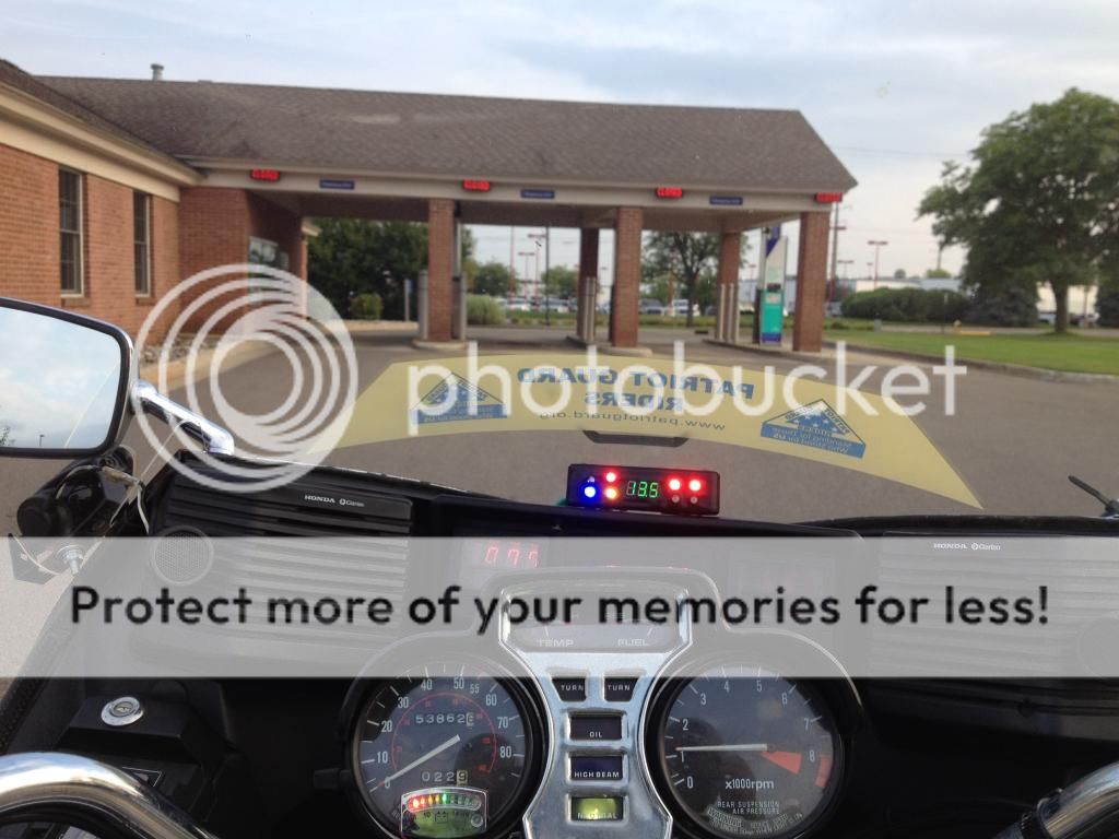

I have both digital (above the dash) and bar graph (stuck on the speedo) on my Goldwing.  If I were to choose one, I'd say go with the bar graph type.  The digital is great for diagnosing electrical issues no doubt, but it can be too much info when on a ride.  You don't want to be in the middle of some highly technical twisties thinking "Why is my regulator putting out 0.2 volts more than usual?"

Offline Whaleman

How well dampened are the analog gauge movements you have?  I tried a cheepo voltage gauge and found that the lack of dampening caused the needle to jump so much as to be unusable.

I have no problem. If anything the voltage gauge moves too slow as if it is over damped. Dan
