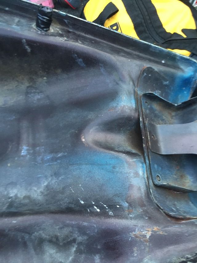

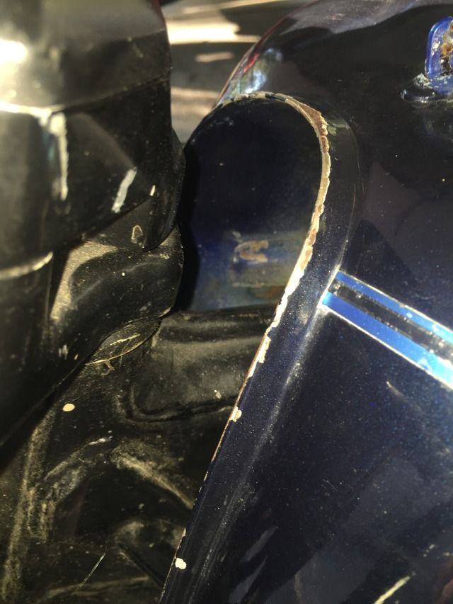

I know that this seems stupid but my tank no longer fits on my bike. I lower the triple tree to put clip ons on but I don't feel that would change anything cause both points of attachment move together. I feel like maybe when I took it to get the tank lined maybe they some how cause the tank to bulge out on the bottom. It's hitting on the neck of the frame( not sure if that's correct term). I might go talk to them tomorrow unless anyone has another idea of what could of happened. I took some pictures of the tank to try to show where it's hitting and where it seems it may be bulging. Has anyone had this happen when they or someone else lined the inside of your tank?
The little marks is where it is hitting.
Trying to show it here. Opinions and thoughts please.

Pics don't show much. How can pouring a liquid in your tank make the metal Bulge? Not sure what the issue is.

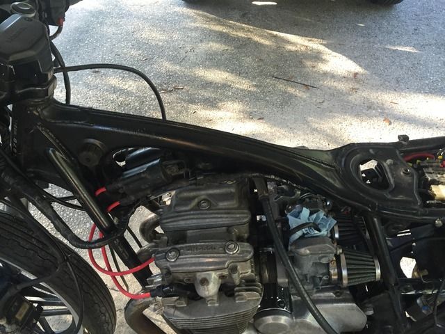

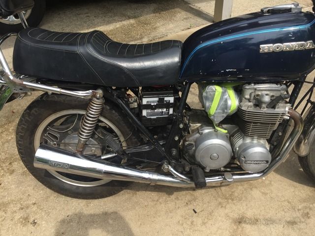

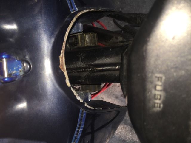

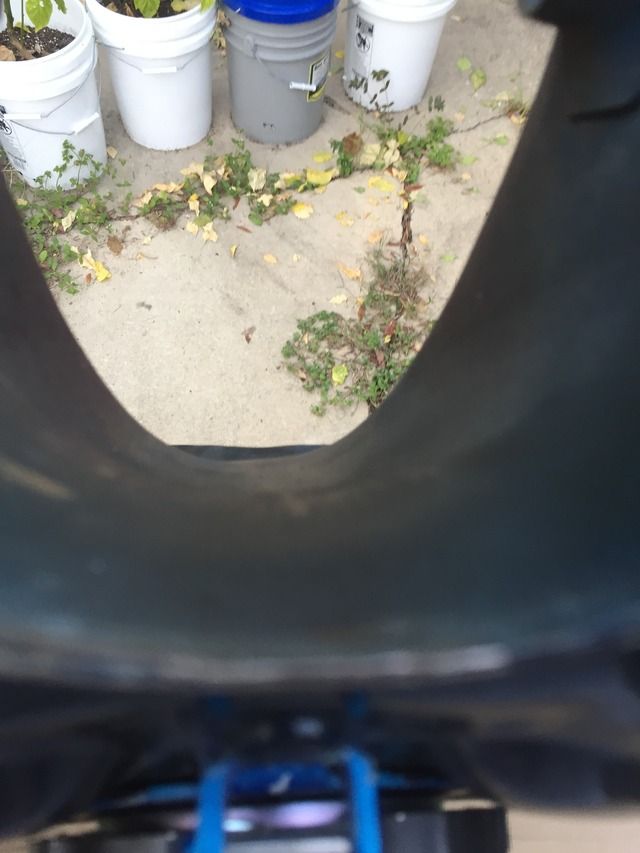

Of course im not going o go in there and start accusing them! i just dont know how it happened. I did clean it with some vinegar but i had it installed on the bike sense then before i sent it to shop. Here are some better pictures showing how off the tank is. Unfortunately i dont have great pictures of before. Here is before
Here is showing that i have nothing in the way of the tank.
If i put the bolt part in place first the front cant even go down enough to reach the bung. This is a side shot of how high up the tank is sitting.
This is a birds eye pic of how apart the hoops are that connect to the rubber bungs. i have not changed the bungs either.
And if i put the hoops on the bung which is very loose and has alot of play back and forth this is how it sits where the bolt would go on the seat.
Thanks again for looking and helping.
