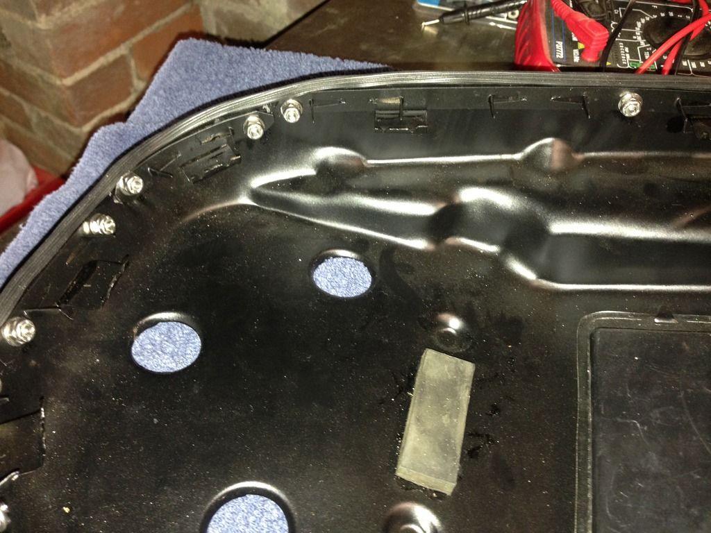

« Reply #77 on: February 19, 2016, 04:27:44 PM »

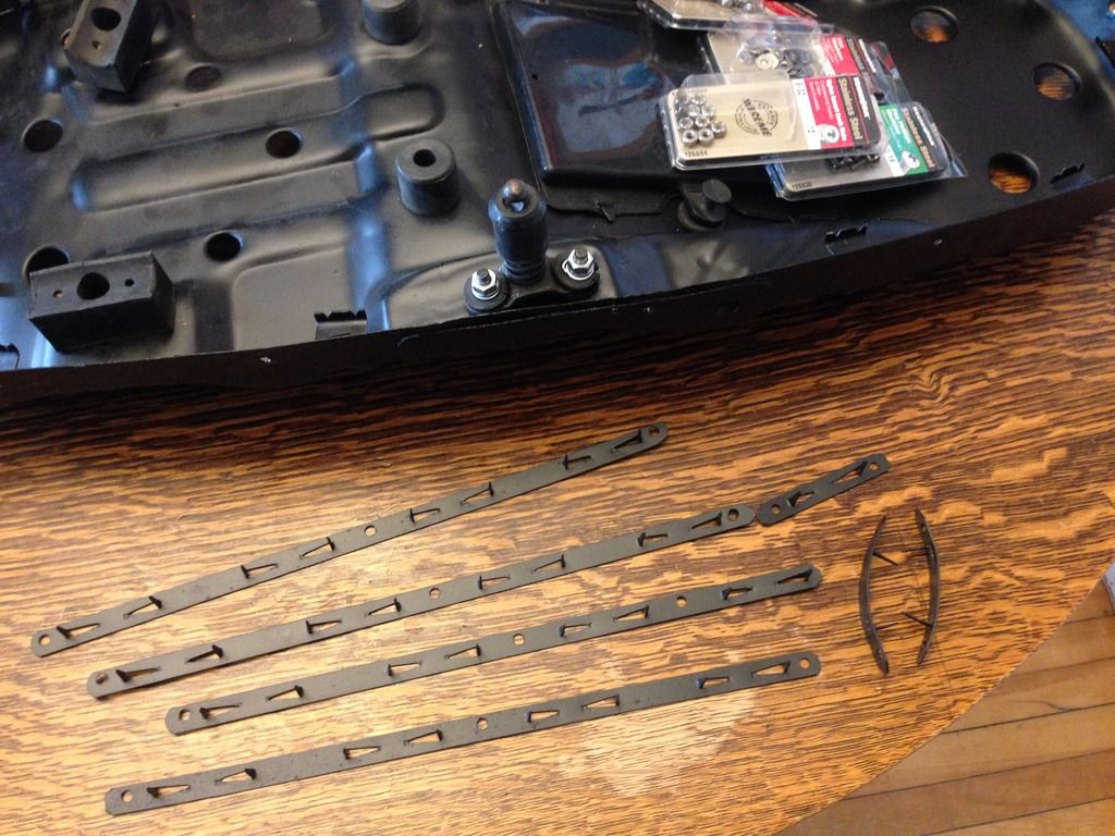

Made a bit more progress this week. I got another load of parts sandblasted and ready for powder. I got the jugs, head and cam cover through the first round of sonic cleaning and scrubbing.
As for pictures, I cut, fit and powdered the new seat cover tack strip and got them installed:
I also sorted out my ignition switch which wasn't working. With the key in the "on" or "park" positions, I had no continuity from the red battery wire to any of the other wires. After tearing it apart, I found that the battery lead had corroded away and no longer made contact with the switch.
A bit of solder and some 220 grit sand paper resolved the issue.

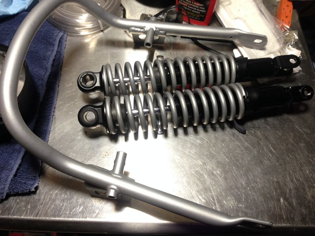

Re: 1972 "CB525" Backyard Rescue
« Reply #78 on: February 22, 2016, 06:59:09 AM »

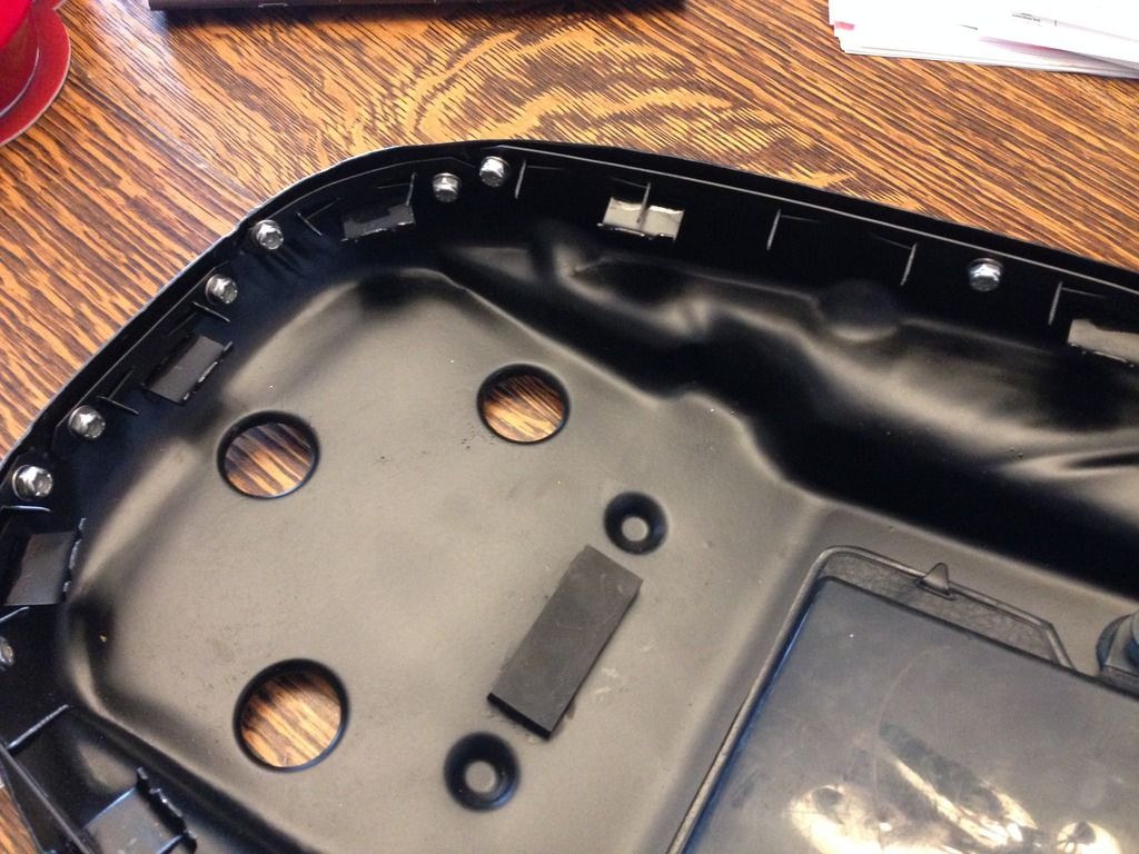

The seat pan edge was a bit sharp and jagged for my comfort. I grabbed some screen spline, cut a split in it lengthwise and used it to wrap the edge. I used a few very small dabs of silicone to hold it in place.
I also got some more powder coating done.

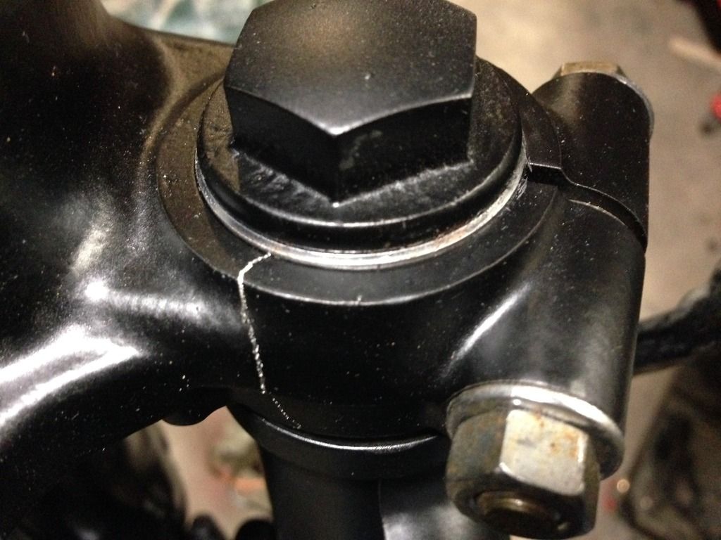

Well, crap.....
My replacement top tree is now also scrap. After sliding the fork tubes in and properly installing the D washers, I started tightening the pinch bolt but the fork clamp cracked after only about a 1/4 turn. it must have had a hairline fracture in it that I didn't notice before powdering. Time to walk away and have a beer before something else breaks.

Walking away was a wise choice.  Now I'm going to be paranoid about mine.

I think the powder on the inside of the clamp was (at least part of) the cause. I will make sure to tape off the inside rim on the next set.

Thanks cal, that makes me feel a bit better. I was able to find a replacement in the parts section and nicks2319 already has it shipped out. I am yet again convinced that this forum is downright invaluable.

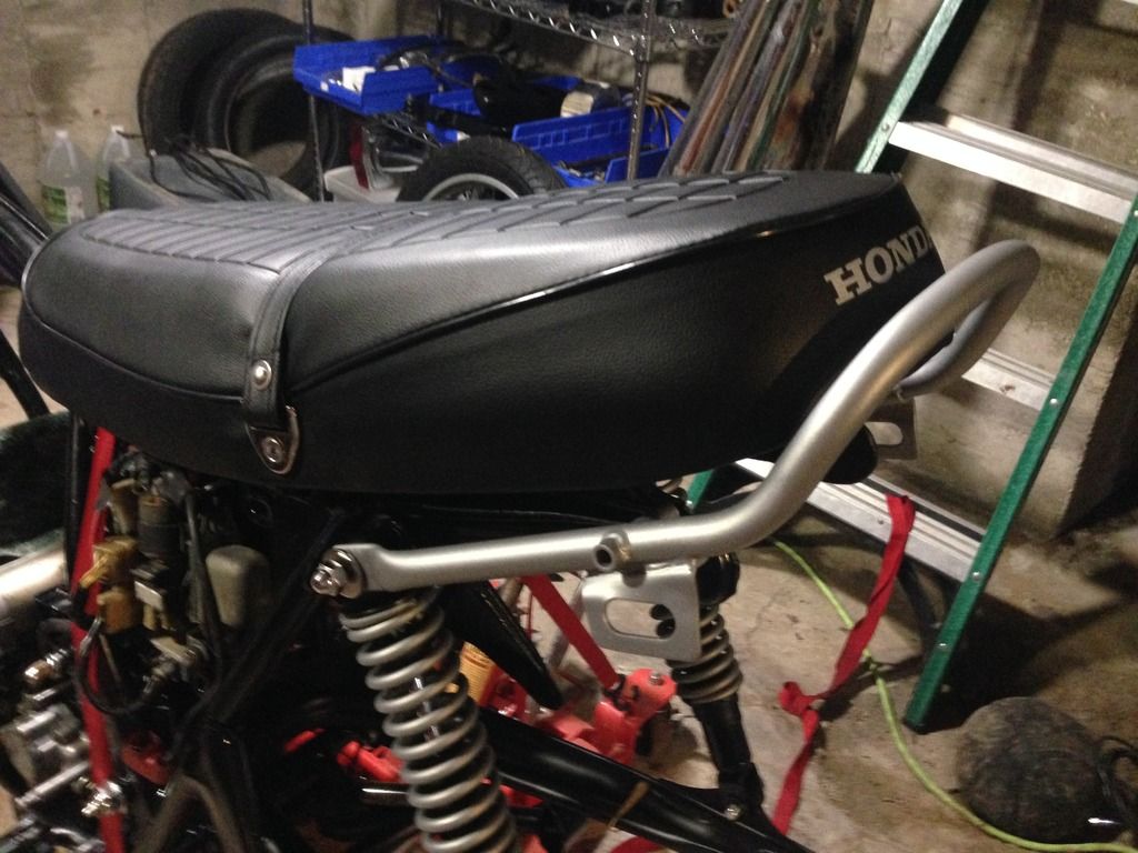

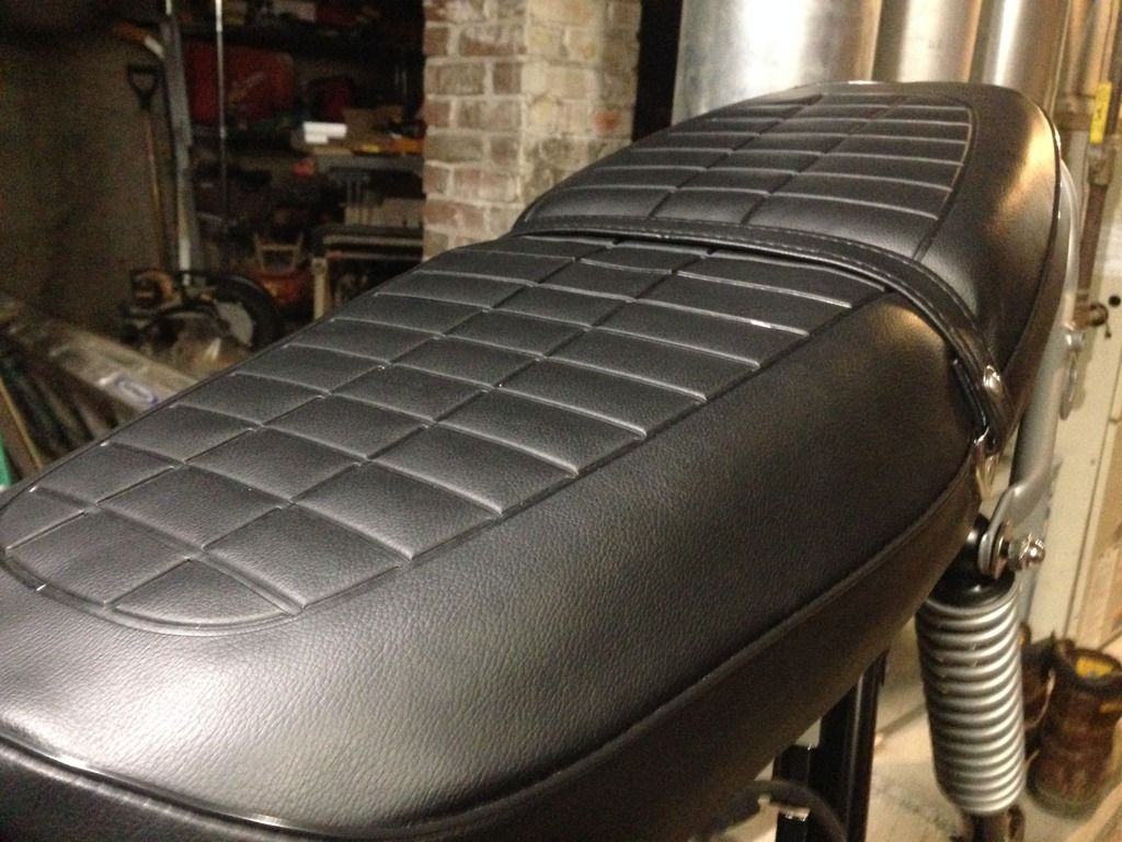

I finally got the seat cover on. Those upholstery strips worked amazingly well. It came out better than I expected a $25 eBay cover to look. It's sitting a little funny in the photo because I just set it on top of the frame and the seat latch held it up. I'm not quite ready to fully install it yet.

« Reply #85 on: March 01, 2016, 05:05:34 PM »
The seat turned out well!

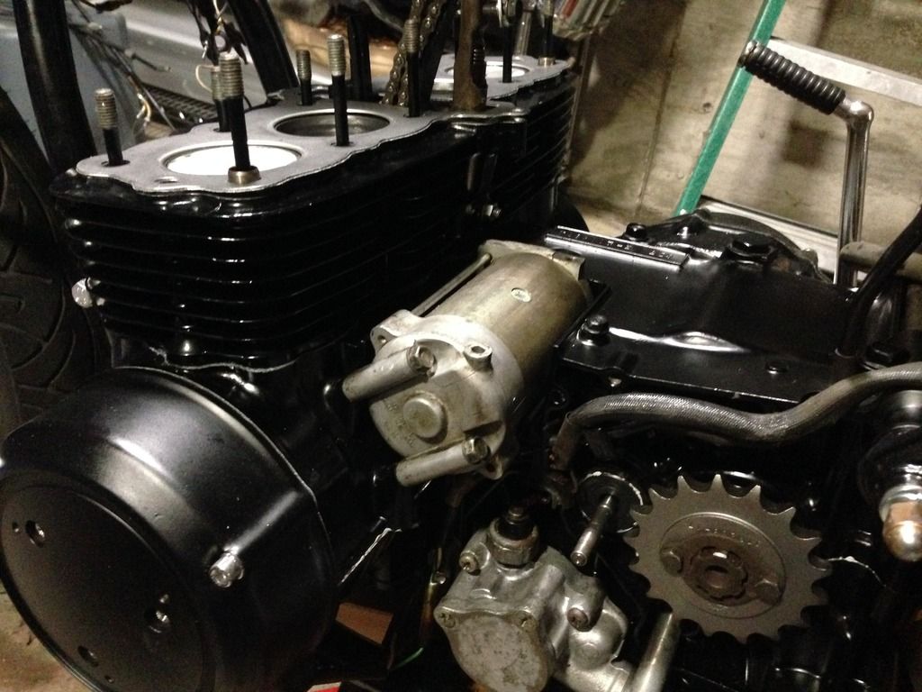

Work progresses, albeit slowly. I finished the jugs and got those reinstalled:

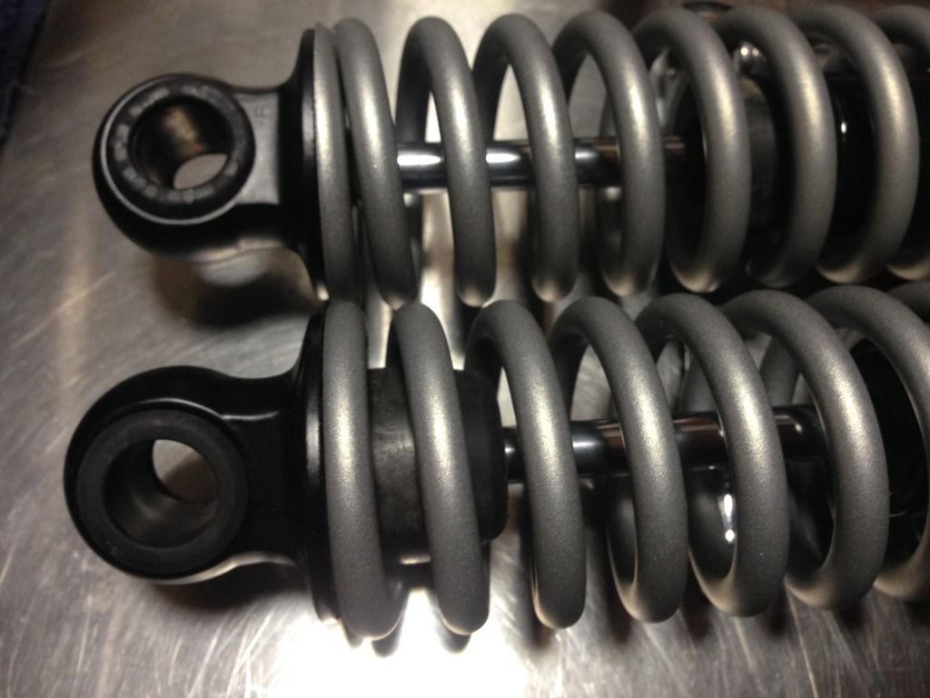

For some reason, some of my aluminum parts are coming out glossier than others even though I am using the same powder and application/baking process. I'm going ahead with it and hoping it will be less noticeable once everything is all together.

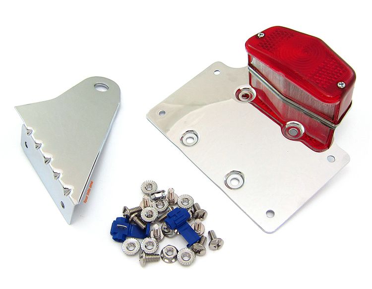

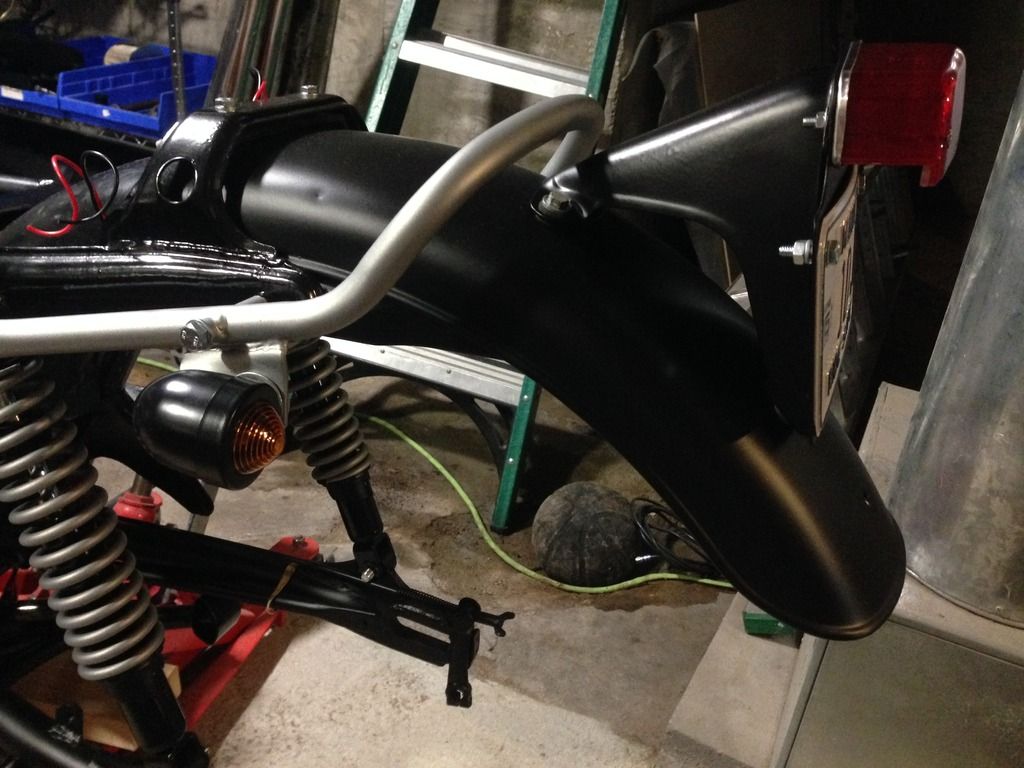

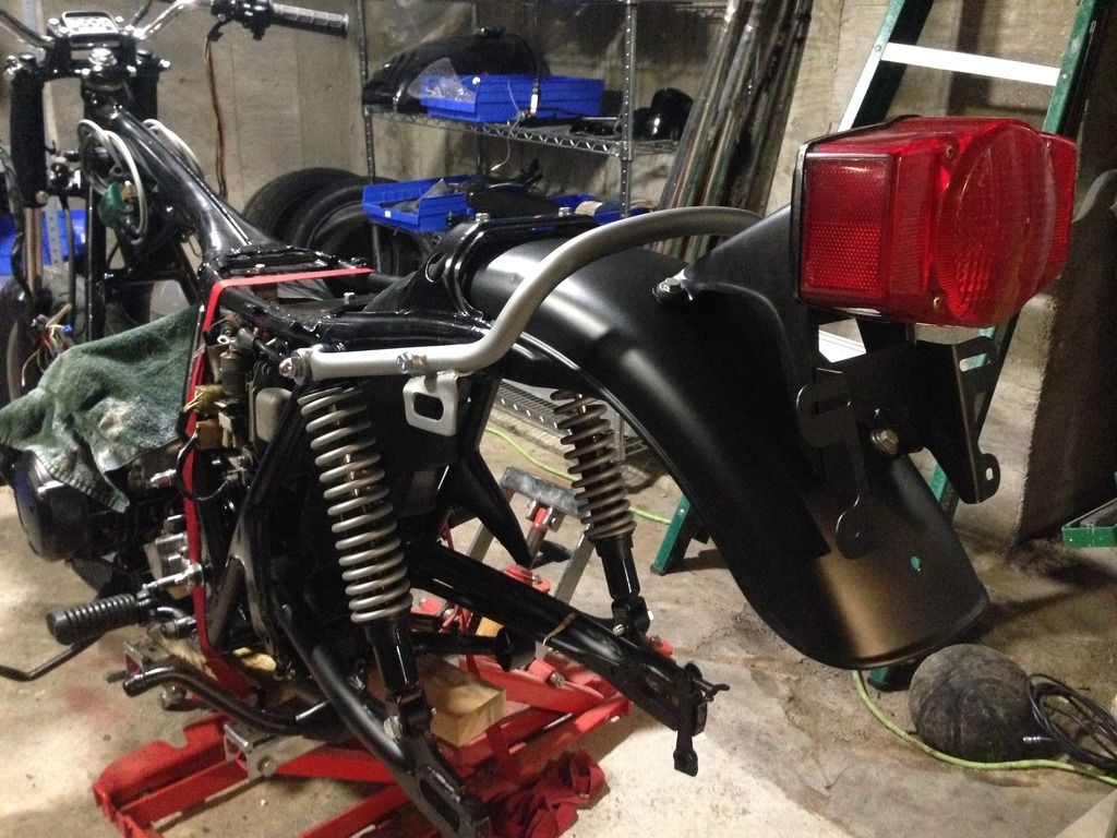

I also got the rear fender powdered and reinstalled. Though, I really hate the stock tail light. So, I'm tearing it off and am going to mount a spare Lucas light that I have. Hopefully, it will look better:
« Reply #88 on: March 14, 2016, 12:17:48 PM »
I like the finish of the powdercoat but I agree as to the size of the stock taillight.  A Lucas light will look better, but I'm probably biased since I used the same shaped light.

Yeah, I have an old axle mount plate with a lucas light on it. I'm going to try cutting off the stock license plate bracket and mount the axle plate mount without the 90 degree bracket straight to the stock tail light bracket. Hopefilly it looks decent. Otherwise, I'll just pick up a new lucas light with mount and use that.
This is what I have to work with:

If not, maybe you can source the angled-to-the-fender mount.

Yeah, I would most likely grab another one like the light I put on my other CB500.

Some more progress. I found a rust hole in the front fender underneath the strut. Since the front of the fender had already been chopped I didn't feel so bad about cutting off a bit more. I tried to leave enough so that it's still useful but not so much that I would need to refit the strut. I this I can live with the results.
I also finished modifying the tail light. It's still a tad on the tall side for my taste but it's far better than the stock light and didn't cost me anything but time. I think I'll like it more once the seat and wheel are back on.

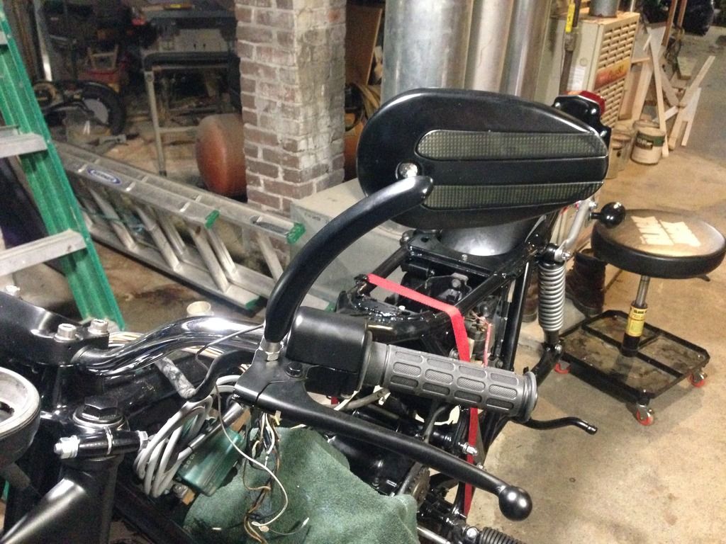

    And the turn signals/mirrors mounted:

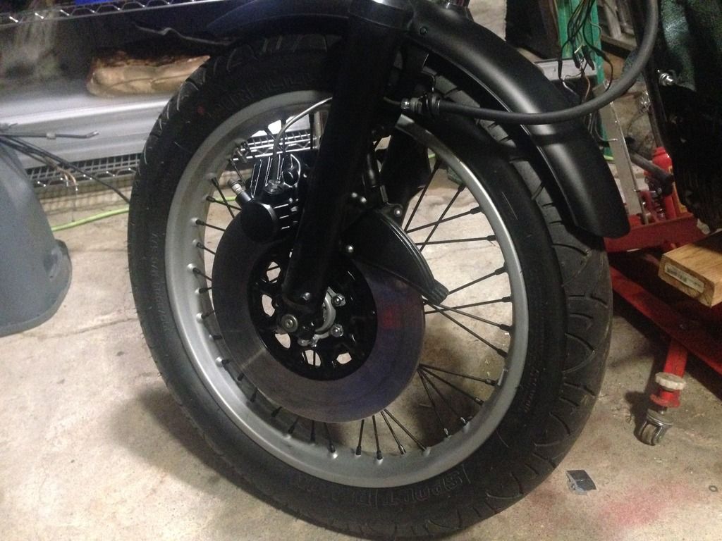

    After rooting around in a few attics and basements, I've also come up with enough spare parts to go with dual front disks. I powdered the rotor and caliper assembly and am now working on locating a larger master cylinder to support the extra disk.
    On a side note, does anyone know what model bike these calipers came off of? The fins on them are not standard SOHC CB calipers and the bleeder screw is larger than normal as well. I need to find bleeders that will fit both of them as the hex head on both were stripped off.

    Looks great, wish I had the equip and space to powder. That caliper looks like my 750 K4.

    Also, thanks for identifying the caliper. That was exactly what I needed:
    http://www.cmsnl.com/honda-cb750-four-k4-1974-usa_model482/bleeder_45109300003/
    Also, in case anyone was concerned, those yellow rims in the background are not for this bike. Those are going on a friend's Kenny Roberts inspired XS1100. Here's a shot of them all done.
