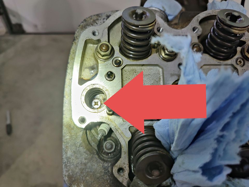

Went to remove the 4 small bolts in the cavities... realized I likely need a long impact driver bit? Tried a regular JIS 3 screwdriver and its not going to break free  with that. Tried the thinnest walled 10mm socket I had and it was slipping off just spinning it with an extension by hand without a wrench.
In the book it says to use a flat wrench. That does not seem to be the case with my head? Am I correct in that I need to go get a long JIS 3 impact driver bit?
I misread, says the outside ones can be reached with a wrench but "A thinwall 10mm socket, or Showa T-handle 10mm, may be required as the crosspoint heads will usually strip in the attempt, if corroded." for the inboard ones. The picture shows a wrench so my brain got confused. haha
I am not even going to attempt to use a JIS3 cross point given how everything else has gone. I guess my new questions are:
1) Since none of my 10mm sockets are thin walled enough does someone have an amazon or other link to one that would work?
2) Lacking a socket suggestion, does someone have a 10mm T-handle that will be thin walled enough?
Thanks everyone!

sometimes you can put the driver bit in a socket, put the socket on an extension, extension on the driver and do it that way.  Never had any trouble using 1/4" drive regular socket on those.  The torque spec for them is low but they are probably at least somewhat stuck
I tried the bit in the extension, immediately started to strip the cross-point head out. Its weird I have about 5 or 6 different 10mm sockets and none of them seat nicely at all. I guess I could try to hammer them on but that seems like a really bad idea.
Let me dig around more and see if I can find something with an even thinner wall. Running out of places to look though. haha

Use a pick or something to dig out all the dirt particles from around the bolt.

I can offer this, having stumbled into it recently: at Harbor Freight they have a 1/4" drive socket set with a 10mm socket that fits. You'll have to also (probably) get their 3/8"-to1/4" adapter, but it works, and is cheap!

Thank you everyone! I found a 1/4inch Craftsman 5 point long socket that finally worked. They came off without too much of a fight.
So embarrassing but I bought these harbor freight magnetic socket organizers and the first ones I attempted to organize was the long 1/4". I didn't finish and left the organizer in the top of the tool box covered with a bunch of crap. Figures it was that ONE out of a dozen (admittedly only one other 1/4") that worked.
I felt like I had taken crazy pills.
