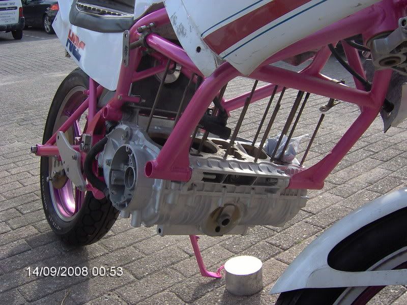

kinda like this bike from satanicmech.'s website

not seen Rick Denoon's 400f mentioned http://www.denoonsp.com/serv011.htm is he still a member here?

On any backbone backbone frame (like the one above) the engine acts as a stressed member. When Egli built a frame for a specific Kawa engine which had the engine mounted in rubbers, these rubber mounts on the engine had to be replaced with rigid parts to ensure stiffness of the frame.

Years ago one of the members here had a pink Martin frame, I saved the pics because I wanted to copy it. They are on one of these darn computers somewhere.

Here's some of those pics I saved. I want to know what is under the tank.
I think that if the frame is designed right it won't stress the engine much if at all, but I'm not an engineer, so who knows.

THose are some amazing frames.

Those nice custom frames pictured Matin or Martin ? I like'em !
