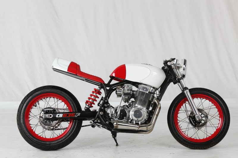

Finally got oil pressure after pulling the gauge out and pouring oil in the hole where it mounts. Picked up an electronic relay for the blinkers and buttoned up all the wiring. Got a one piece stainless steal braided brake line from http://slingshot-cycles.com
Had to trim the seat up a bit to make it fit better with the new seat pad and then had a friend paint the tank and seat...
Ran all the fuel lines and installed the headlight with new chrome ring, tank and seat, new decal...
It needs more decals or pin stripes or something, still not sure what to add yet. Right after taking this pic i put a gallon of gas in and was about to see if it fires when the petcock started leaking gas like mad in the off position! So had to stuff a rag around there and pull the seat and tank back off. It was leaking from one of the barbed copper tubes, bad o ring or washer maybe in the petcock?? I ordered a rebuild kit but it probably won't be here until the middle of next week!! I was hoping to spend the holiday weekend tuning and working the bugs out!  >:( I guess i can spend the weekend drinking beer since there will be no riding.
Still waiting for gauges and air filters which should also be here next week! Could use a shorter clutch cable also  :P
I'm hoping to get it running well enough to take it to up north Tomahawk WI for the annual Fall Ride in 2 weeks, even though it's mostly a Harley rally. Hope to be updating this thread soon with video of the bike running.

Resealed the gas tank with Caswell's Epoxy (great stuff!), installed gauges, mirrors, air filters, rebuilt petcock, new fuel injector hose for the fuel line and removed the leaky inline filters. Filled the tank last night and the exterior is still dry as a bone today so hopefully we're good to go! Registered the bike this morning so I'm legal now. If the weather dries up I'll take it out this evening and see if the bugs are ironed out.
Tach only goes to 8k but i got a deal on it :P
If anyone's interested I found that ordering the K&N filters individually was cheaper than ordering the set of 4. These were part number RC-0160 which are .5" longer and don't taper but I like the look.
Made a steel plate side cover that doesn't stick out as much as the OEM plastic ones.

Put about 250 miles on since the rebuild. Recently put in 130 main jets and adjusted the needles as much as possible to give it more fuel. It runs good but at 50mph or more it doesn't like to maintain a speed even though it accelerates great. It will maintain a speed but you can hear it stumble slightly as if it were running out of fuel. It's much better than it was with the needles adjusted and new jets but still feels like it's wanting more fuel while cruising at like 1/4 to 1/2 throttle, but only while doing 50mph or more.
Added some pin stripe decals to the top of the tank and seat, bar end mirrors, and a new clutch cable.
Also added some HM wing decals to the oil tank and the side cover.
Made a steel plate side cover, it ended up a little crooked when bolted on but im happy with it.
Think I'm calling it DONE! Or done until I can afford one of the CycleX "Git Kits"  ;D

Looks fast, but I'm not sure that those bicycle disks on the front are up to the task of stopping it. Plus that downward angle won't do any favors for fuel flow.
Seems like more of a trailer to the show than get up and go bike.
It is pretty though.
Re: Score! **750 cafe build** Completed!
« Reply #74 on: May 17, 2013, 07:40:43 PM »
Nice inspiration, but I have to agree about the practicality of those brakes and the mounting angle of the tank.
