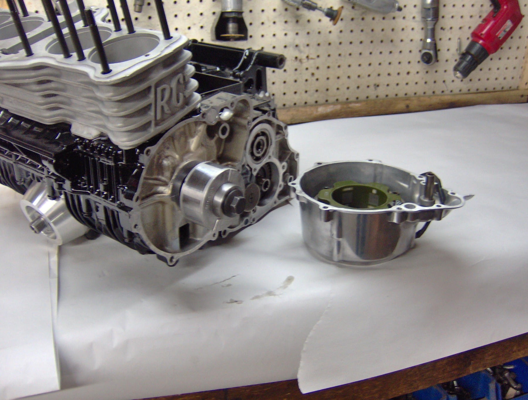

Guess what I just bought...
along with
and
 ;D
Got them from Dynoman Performance.
« Last Edit: May 28, 2010, 01:17:45 PM by soichiro »

The Cycle X system I'm interested in is this one:
You can read about it on CyX's webpage:
http://www.cyclexchange.net/Elec%20System%20Comp%20Page.htm
It allows for a battery-less system - which is the attraction for me.
All I have to do is make sure it is compatible with the Dyna 2000.  That is, I need to know if the Dyna 2000 needs power before the engine is actually running, or if it can do its thing with no initial voltage applied to it.  Because, a battery-less system will only provide power to the Dyna 2000 when the engine is turning.  Maybe the rotation from the kick starter would be enough to get the entire CyX+Dyna system going.  That's what I got to find out.
Of course, if any of you know the answer, let me know!   :)

Maybe the rotation from the kick starter would be enough to get the entire CycleX+Dyna system going.  That's what I got to find out.
Because it's a permanent magnet system, unlike the Honda one, it will generate current with a flat battery or no battery at all.  However, you would likely want to incorporate a capacitor into the charging system to really make batteryless operation painless.  There's one manufactured by BHC (63 vdc, 4,700 uF) that I used on a total loss race bike a few years back with good results.
The good news is that they're common and cheap: http://www.newark.com/panasonic/ecos1ja472ca/capacitor-4700uf-63v-capacitor/dp/01M7489 Or you could spend more to buy a "kit", http://www.summitracing.com/parts/ALM-151308

« Reply #70 on: May 29, 2010, 09:05:18 AM »
Thanks for the tip, David.
Yeah, that system would be nice to have in the event of the zombie apocalypse.  I've seen the movie where they couldn't get the engine started in time...  :D
