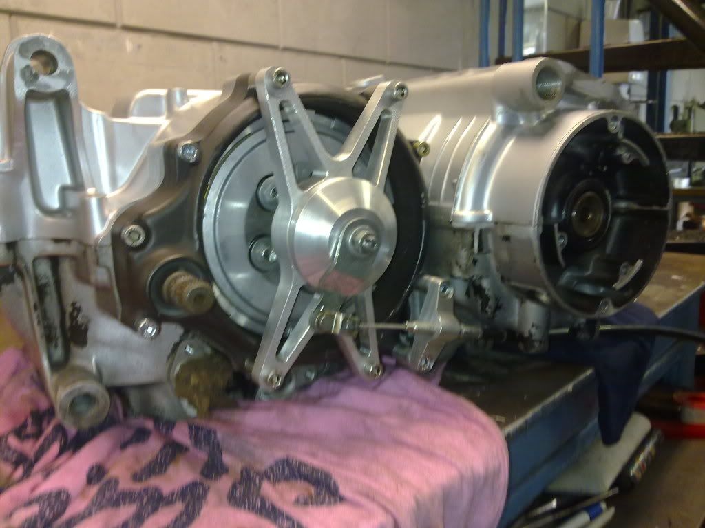

Well today we had a very good day. As it appears now all mechanical functions work well. Assembled the clutch into the engine, had to adjust the oilseal/basket distance somewhat and happy to inform that nothing stands in the way of mistreating that clutch on the street/track. All looking very good. ;)
        Congratulations Rob. Nice work sir.
MAN that looks cool Rob!!!  you should def. PM me a price estimate!!!  just to make sure that all my ducks are in a row and that i can seriously afford it...  hopefully i can, but i wanna make sure!!!  can't wait to hear the status updates!!

Yes that is cool in so many ways. Wow.   :D   :o

+1! So Cool,I think Calendar Girl needs one.Rob mounts in stock yet? Thanks and Great Job!! Bill

Very nice work. I hope you can meet demand.
