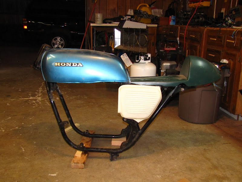

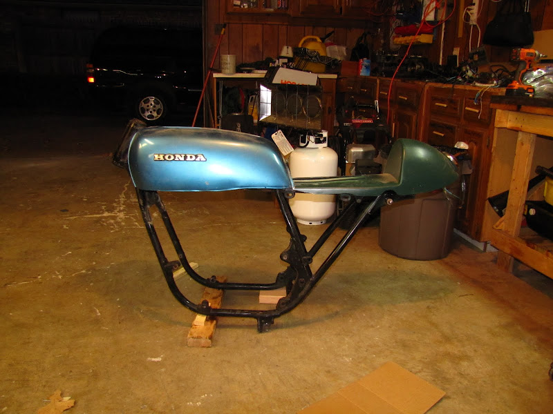

OK, so i need some advice!  here's the way the bike will look, at least somewhat...  the tank is for sure going to be this one, i can't decide if i want to take the plunge on doing knee dents or not.  Andrew (aka Little_Horse) is going to make me a rear seat pan out of aluminum since i'd rather have metal than fiberglass for my "tins"!  the shape will be very similar to the airtech one i have, it will be smoother and a little flatter on the rear so my Carpy tail light will sit flush and look better.
now i can't decide on if i'd like to run Joe's (Frankenbike) ribbed side covers or not.  While they are EXTREMELY trick, i do like a nice clean triangle.  please help me decide!!
with sidecovers:
without:
now you have to keep in mind that the triangle won't be entirely clear.  if i don't use the side covers, then i'll probably use a bung king tank or something and attach it to the back portion of the triangle.  this will clean things up pretty well and still open up the area.  since i'm going to use one of Tintop's intakes, the ledges on the side covers that would normally sit around the air box will look slightly out of place.  please help!!

Do like your the tank and seat combo.
You might want to wait on the side cover decision, until Terry has rec'd the test filter (should be sometime late next week I hope).  It will be tested on a bike with side covers, so I will ask him to post a picture.  Also when I mocked it up on my 750 frame, with engine, carbs, & and a beat up side cover ::) (thanks Frankenstuff for the new ones), it is somewhat farther back than on the 550.  So those bulges should not look out of place.  I plan on running the filter with side covers on this bike (when ever I get around to building it ;)).

I vote not, but that is just an opinion though since I think cafe bike's should be light and look light the open triangle makes it look more greyhound like then with covers.
Oh also when you end up sending me the templates for the seat and cowl you may consider sending the light too so I can do all the work to get everything nicely fit and all.

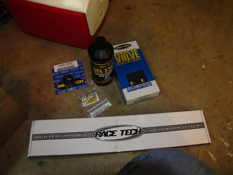

look what showed up in the mail today!!!
now if i can just figure out what's wrong with my slider on one of the tubes, or how to fix it or if i should just let it be, i'll get back to rebuilding the forks!!

I am for no covers if you completely relocate the oil tank and all electronics, including the battery.  Giving the complete open window.  If not keep the covers, IMO.  Nice work and great post on the GL preload adjusters from voxonda.

I'm of the same mind as Little Horse on opening it up, though like Tin Top's 550 I am going to plant my battery firmly in the center of it on a custom made tray.

Since you wanted opinions...
I would vote a definitive NO for putting knee dents in that very good looking tank...and a yes for the ribbed sidecovers ;).

i got another box yesterday!!  now i can finally get working on the motor!  i also got my parts back from the blaster!  hopefully i can post a picture of that tomorrow.  i'm going to keep the "Excel" writing on the wheels!  might paint the inside of the rim the same color as my tins.  have to come up with a color choice asap for that tho...  thoughts??
one question.  where can i get some of those little cylinder fin "spacer" pucks that go on both sides?  the blasters media totally ate most of those away...
*edit*
it'll be about a $20 mistake, but i have a $15 bike bandit gift card, woo!  #5 in the picture below right?
