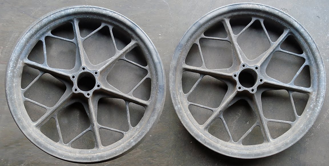

« Reply #71 on: May 26, 2011, 04:20:43 PM »
Those rims look like Kimtabs.  I could be correct, but if I'm right, they're worth a small fortune on ebay (like 800 bucks...)
Offline luceja
  • Posts: 169
Re: James' 77 550f - resto-mod, now with mags!
« Reply #72 on: May 26, 2011, 04:34:04 PM »
I think kimtabs are the snowflake styled ones that are actually magnesium (like this http://4.bp.blogspot.com/-dzU1j0SdLlY/TcScGrFD_8I/AAAAAAAASHY/yoAn_32OcBQ/s1600/KimTabs.jpg) - I only figured they were shelby dowds from this post - http://forums.sohc4.net/index.php?topic=44776.0.
Meanwhile, all balls steering bearings in the mail. Sweet.
« Reply #74 on: May 26, 2011, 08:43:31 PM »
Yup, I was wrong.
