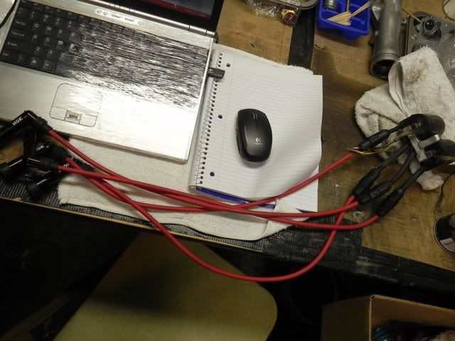

coils have ngk wire splitters with ngk hi performance coper conductor wires with ngk xd05f 5ohm heads with fresh .6mm gapped spark plugs
i do have a multimeter and i set it to 2m setting on my multi meter. connecting the multimeter to the black and yellow, black and blue i get 0 ohm
then when i shove the multimeter leads into head 1&2 and 3&4 i get .025 ohm on setting 2m
^is that the correct? ive tried to read the how to test coils but i didnt get anything it said lol so i need help with that.

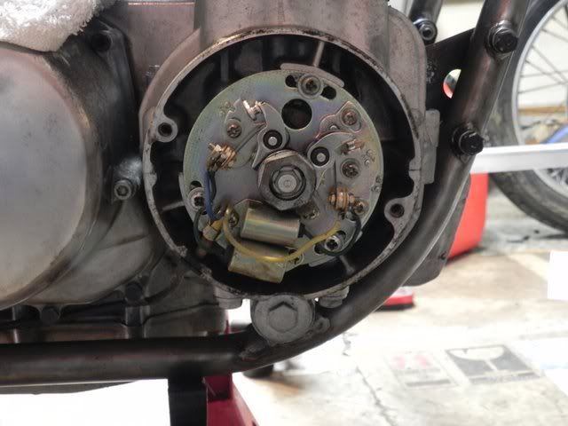

i have fresh points on the bike too

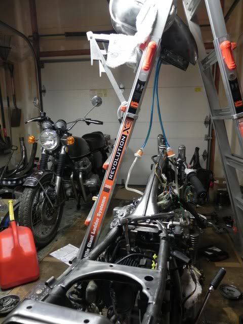

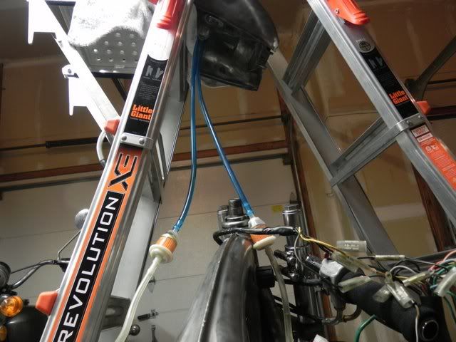

i have my fuel tank suspended on a ladder 7 ft in the air over my bike with a fresh rebuild petcock on a clean tank with gas
1 inline fuel filter are on both lines (they are the super high flow kind pointing in the right direction)

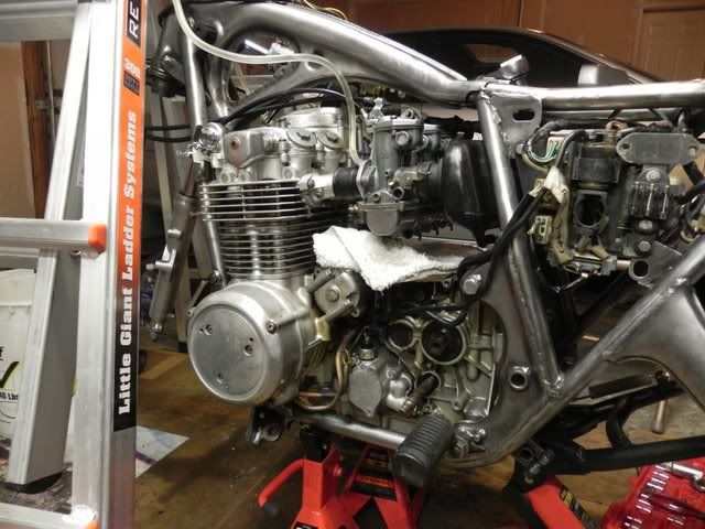

the key switch first click is igniton on,the key cant be pulled out,the second click is ignition off,parking lights come on,key can be removed,,run the battery positive directly to the coil black and white stripe wires,forget about connecting it to the starter solenoid,you wont need the key switch on,,this by passes everything,make up some small jump wires for this,if the bike starts the only way to turn it off will be to remove this wire,with all the plugs out check for spark first or you might be kicking for nothing,get spark first.

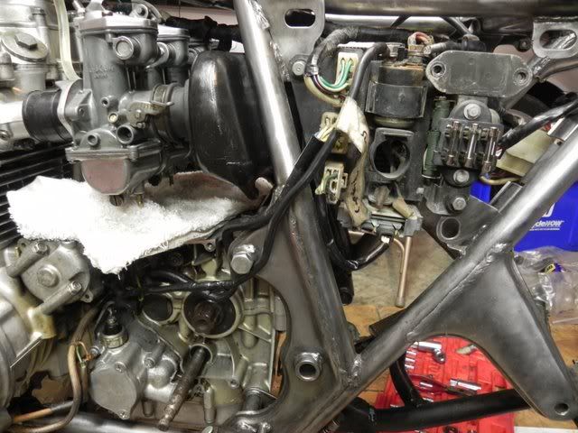

« Reply #2 on: June 29, 2011, 02:07:02 AM »
Second pic appears the start solenoid is wired to frame ground.  You are very lucky that solenoid isn't actuating.  The solenoid is wired with the big wires from batt, to solenoid, to starter.  The starter is case grounded.  The small solenoid wires are switched positive (momentary start switch) and ground.

« Reply #4 on: June 29, 2011, 10:47:00 AM »
the pic might be miss leading
power from battery > starter solenoid > then to starter
thats it. the other pictures with the ground that wire is going from, negative battery > frame and engine grounding potion
