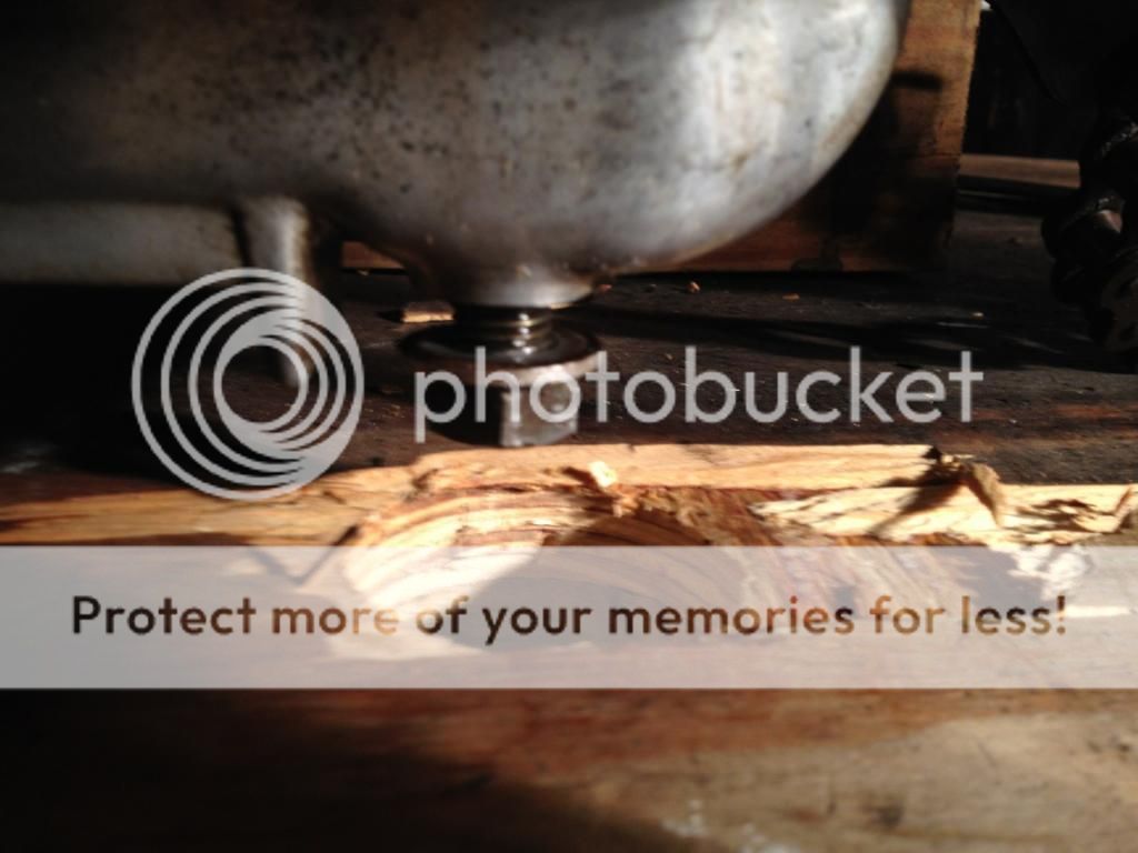

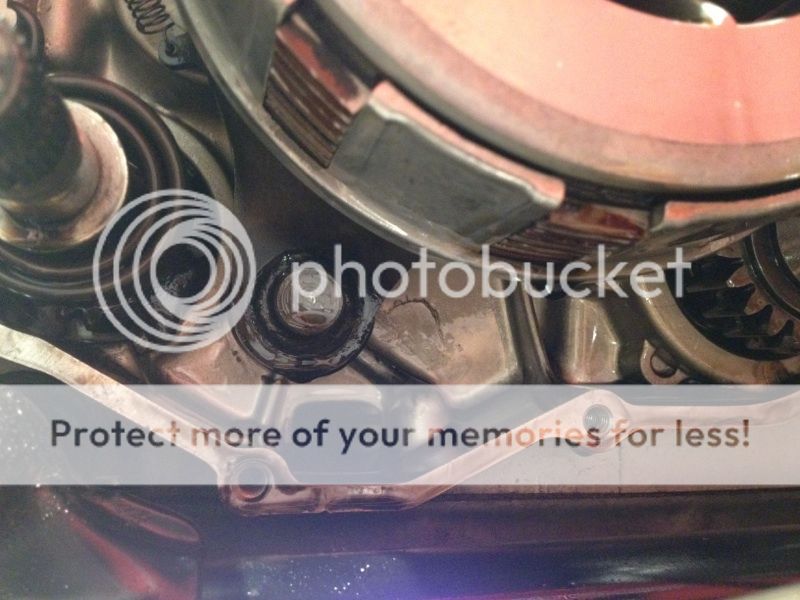

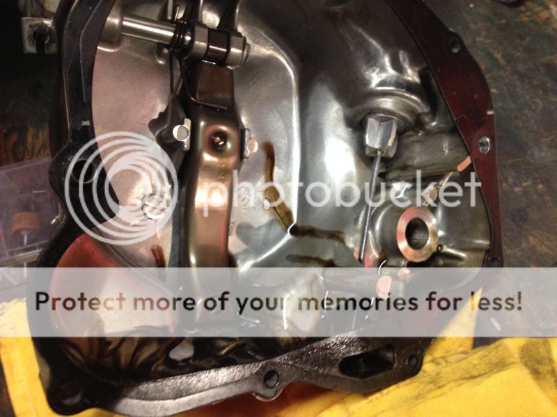

Got to work draining the Oil and removing the Clutch Cover.  Cut a hole in the table and the oil drained right through!
Super Helpful tip from the site. Im a country boy, not an Artist. don't judge!   :D

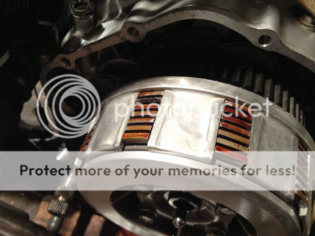

Cant say I really know what a clutch is supposed to look like, but it seems to be ok in there.
There is some sort of sludge in the bottom of the cover, ill have to get it out.

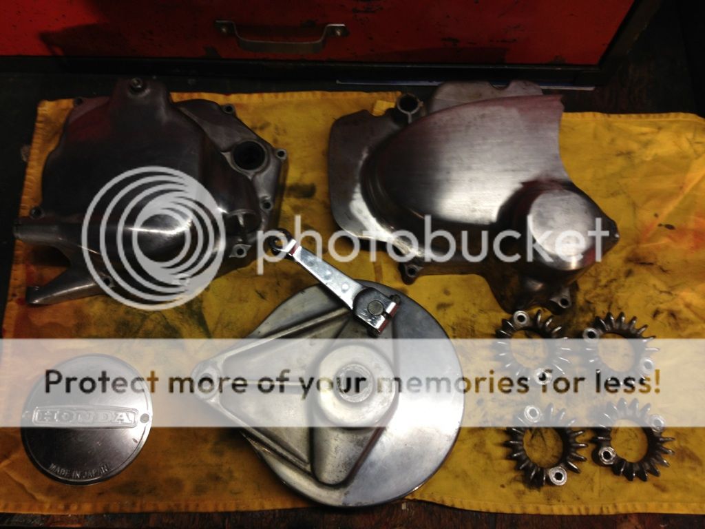

Well this has seen better days, undecided if i want to paint just the "Honda" or paint around it and leave that alone.
Parts waiting to be prepped and high temp painted.

If there is sludge, you may want to pull the oil pan and clean that too.
Isn't that a pretty complicated process?
No, it's just a cover with 10-12 bolts, same as the clutch cover. You will need a new gasket of course. You may be surprised on whats in there?

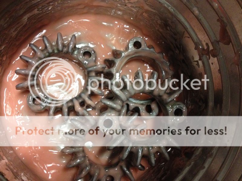

Used most of today up painting, sanding, stripping, prep work, and more and more painting.  Also Painted the side sprocket cover, stator cover, rear brake, and the exhaust flanges.  Il post picture of them later after i check on the curing and how well the high temp paint has set.   But here is a few of today, and a question I am a little worried about.
Soaked these puppies in a chemical mixture I made up and removed all the rust from them.  Almost to good to paint!

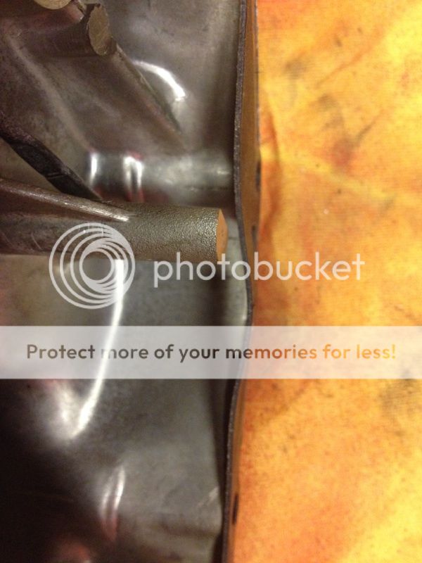

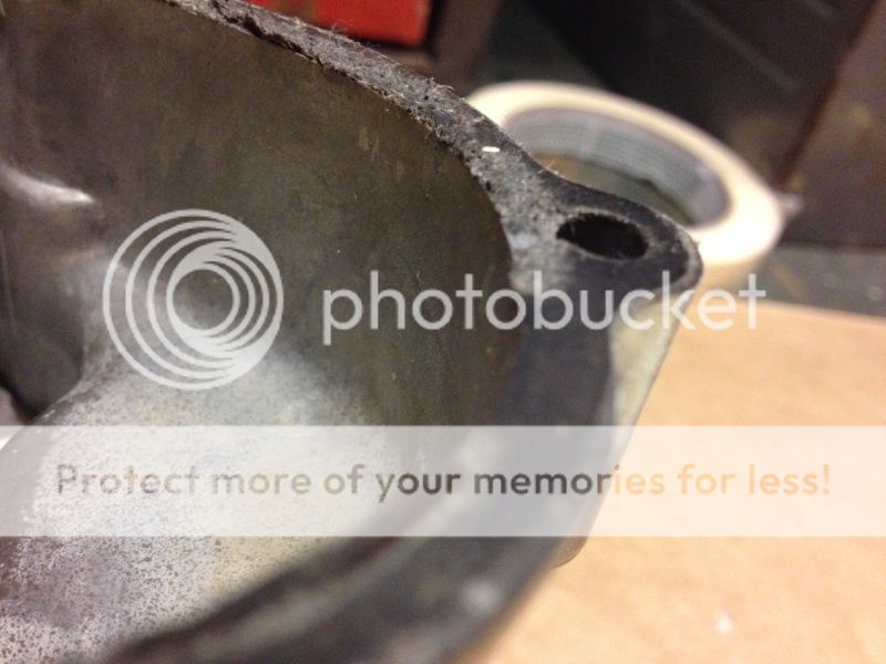

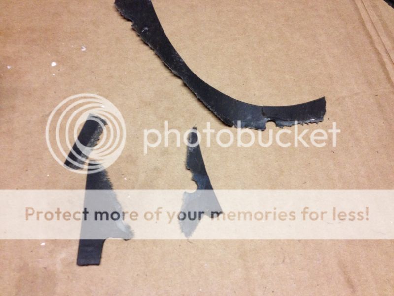

Heres the question, I was beginning to start prep on the clutch cover when I notice the gasket is bent,  Not wanting to risk it i tried to take it off, but it literally crumbled and parts of it are still stuck to the cover, so the new one isn't going to sit flush.
Heres what came off, but the rest is stuck good on there! SOMEONE PLEASE HAVE A TRICK FOR THIS!

  Vesrah is Good quality gaskets man;they'll sell you the complete gasket kit for the whole engine.I bought mine off of ebay from a seller named "motorcycle solutions" Local shops should be able to order it for you also.
I regularly use a one-sided razor blade to clean gaskets off of the covers,be careful about digging into the aluminum though,it'll take persistant patience.They also have a gasket remover spray chemical you can use to soften the gaskets before scraping them off,I usually do it w/o that though because that stuff'll get underneath your fingernails & it's strong acid.

What is this chemical rust removal elixir you speak of?
Re: "The Basement Build!" 1973 Cb350F
« Reply #187 on: March 15, 2014, 05:07:17 PM »
Yes enlighten us about that chemical cocktail.

I buy my gaskets on eBay too.  A sharp chisel and beer will remove the old gasket.

Little bit of Phosphoric Acid, Vinegar as your neutral control, Hydrochloric Acid used with some rice to keep moister and prevent flash rusting, and some heated Nitric Acid in a Polyurethane Tub because they won't break down. SCIENCE!!  ;D Please don't go mixing this stuff in your kitchen though guys!
If I were to soak the bottom of the cover where the gasket is stuck in some WD40 would that soften it up??

brush a little paint remover on it.
thanks ill give that a try tomorrow!
Sounds like a Breaking Bad recipe!
No Bull,could you send me the complete recipe w/ the correct ratio's per each ingredient  and how much to heat ? I'm not a Science major or anything so if you could break it down for me as a blue collar worker guy.I'd LOVE to get my exhaust diffusers looking like that  ;D How does that mix leave the finish of the chrome,still shiny ?
                 Bill
75' CB400F/'bunch o' parts'
« Reply #194 on: March 16, 2014, 08:53:50 AM »
                 Bill
Yes please post it.

OK the mixture isn't super super perfect, it changes on what type of metal because of how quick the covalent bonds will break down the components.  This is what I ran by my chemistry teacher and he advised me to be careful not to add more then this:
2oz of Phosphoric Acid first.
Mix 1oz of Vinegar in with a wooden peg.
OK now make some ready rice in the microwave and add a little water, because this will stop the flash rust issue. Then 1oz Hydrochloric Acid and make a "mash" and add that in.   Heat up some Nitric Acid OUTSIDE to about 95 and let it cool to about 80 and mix it in.  In your poly tub drop your flanges in and shake the crap out of it.  Let it sit 24 hours and wash em off.  Wear gloves! and be careful.  After you strip them mine have come out shiny I'm not sure what happens to the metal but this has worked twice for mine!  I wouldn't recommend this for other parts as I'm not sure what would happen.

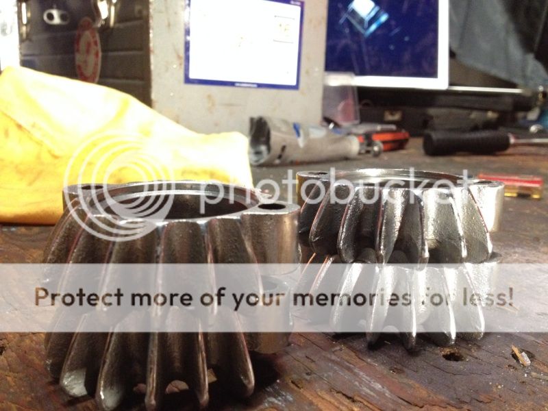

Does the chrome still shine ? show a pic.
I just Painted them. but yes it shined!

I was thinking of doing that chemical bath treatment as you've described and then using High heat silver I'd spray some into a cap and then paint only the parts that're bare metal;I'd polish the paint back toward the chrome just a little w/ fine steel wool.
But that's just me,if I had the $ I'd rechrome it All.  ::)
Your idea seems like it would work just fine, but for me it was mostly to remove impurities and rust so the paint would seal correctly. Im pretty sure these will get the most heat being right on the exhaust head.
