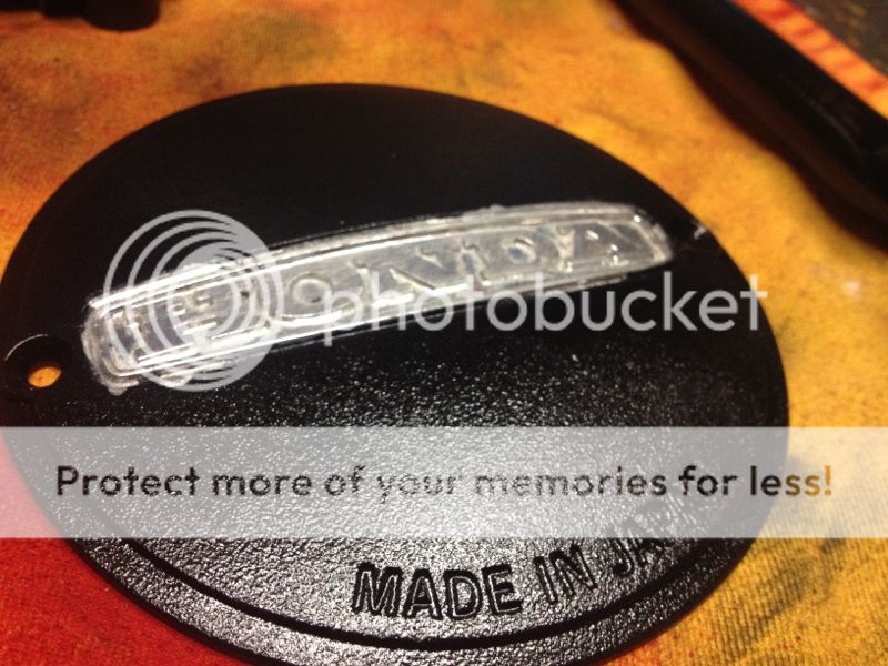

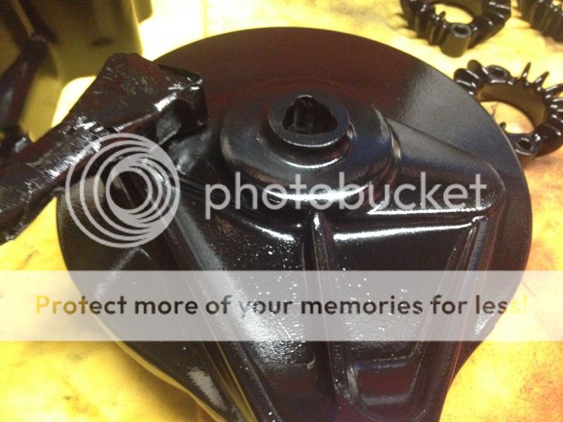

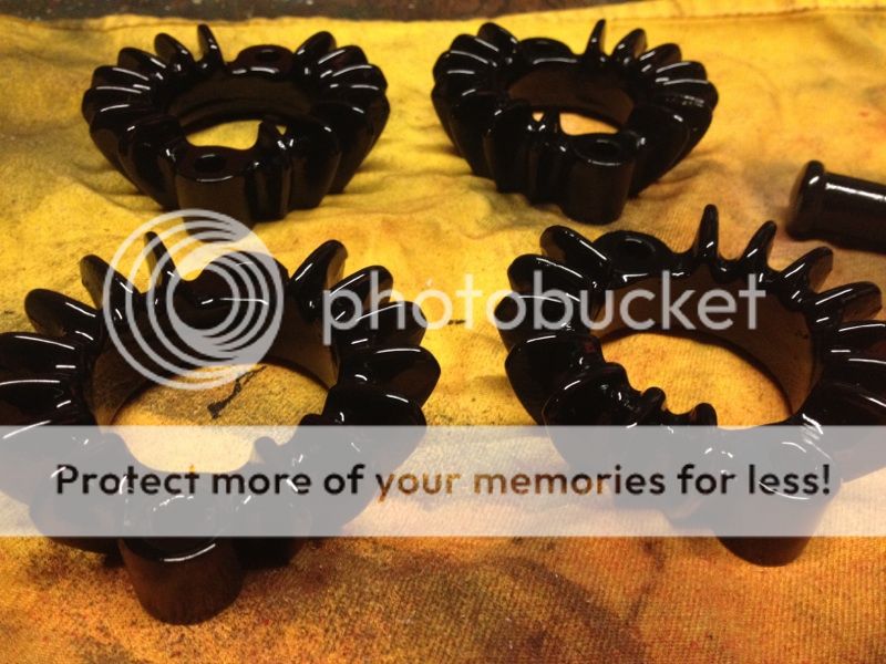

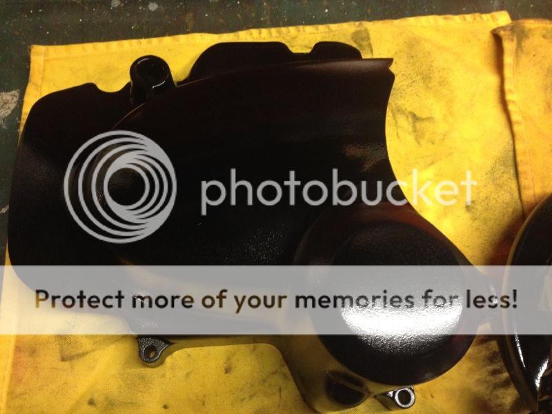

Hahaha bad weather again in Maryland! You know what that means! Free Shop Time!
Parts high temp painted, besides the clutch cover that I'm still trying to get the gasket off.  That will also get painted, then bake them all in the oven!
Remember these??
This one didn't come out quite that great because my heat gun melted some of the tape I was using to cover the "Honda" Im thinking maybe I will paint that in Silver or White, what do you all think??

2 stroke,
What type of paint did you use? and what temp and duration in the oven ?
                    Thanks
75' CB400F/'bunch o' parts'
Offline 2strokeTrush
  • Can you get that back together sonny?
  • Posts: 608
Re: "The Basement Build!" 1973 Cb350F
« Reply #205 on: March 17, 2014, 07:25:54 AM »
2 stroke,
                    Thanks
Its called VHT paint and its from Advanced Auto but you can most likely get it anywhere.  High heat primer as well though.  and its 200  degrees for either 1 or 2 hours i can't remember, but its on the back of the can!

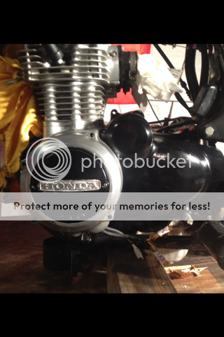

« Reply #222 on: March 19, 2014, 07:08:28 PM »

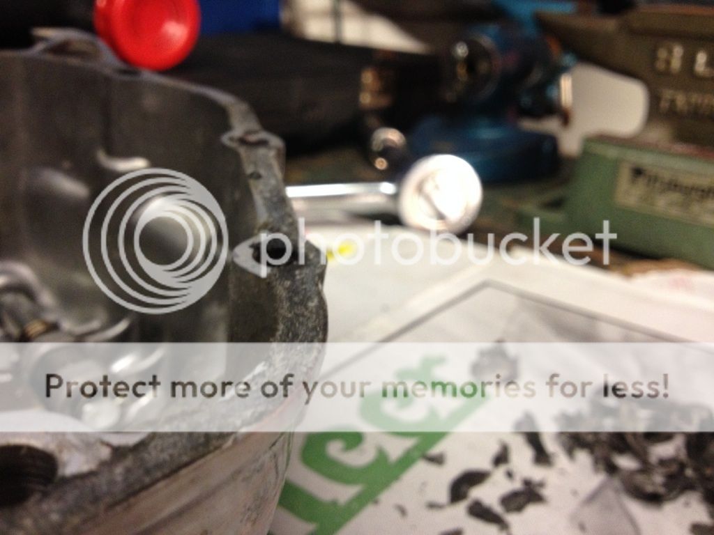

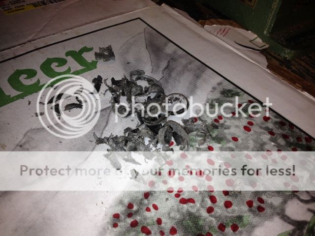

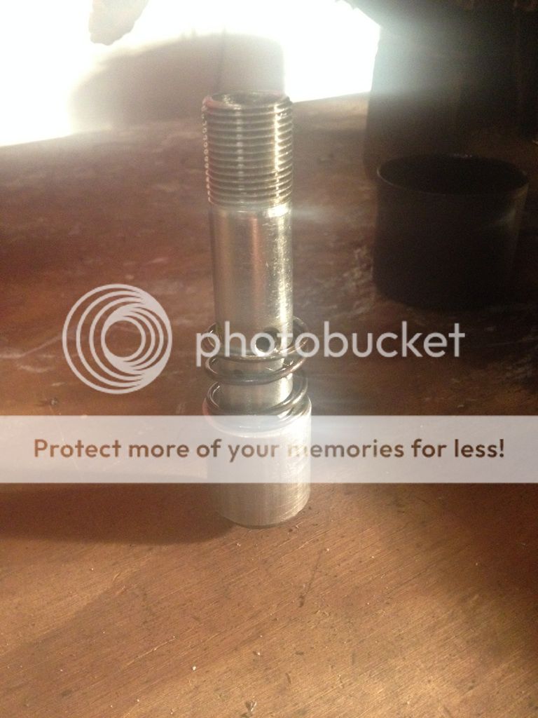

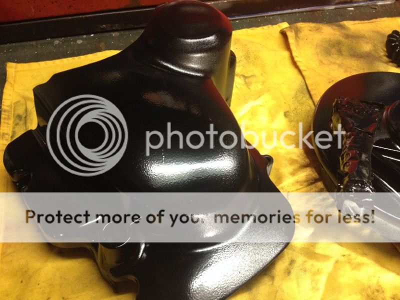

Still fighting getting the old gasket off.  This is really setting me back in time.
Also got the Oil filter off. No problems, I was afraid it would be since it had rust on the bolt, Win! Ill change the filter, and  Contemplating painting the housing as well.
Crappy Picture, but i threw the painted parts just to see what it looks like!

The paint near the oil filter on the frame looks great.

These work really good for removing old gaskets. The threaded part is 1/4". I take a long 1/4" bolt and cut the head off. Thread it into the roloc adapter and use a 3/8 hand drill for the stud you just made. wa la you have gasket grinder. If you go this route BE CAREFUL with these things!! They will take aluminum off in a hurry and ruin your cover.   They generally have them at a local hardware store or maybe even home depot.
http://solutions.3m.com/wps/portal/3M/en_US/3MIndustrial/Abrasives/Products/~/3M-Roloc-Gasket-Removal-Disc-Pad-Assembly?N=7581717+3294228578&rt=rud
