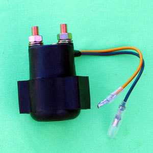

So I ordered a new starter solenoid and a combined regulator/rectifier as well
