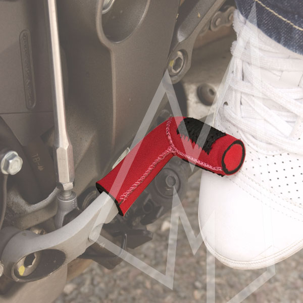

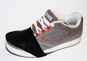

Get a little shifter sock!!
Offline revive_the_550
  • Posts: 34
Re: Reviving the Old 550
« Reply #24 on: October 28, 2014, 08:17:23 PM »
This could work
Or maybe this
But...honestly I don't care too much. Just makes me pay more attention while riding.
