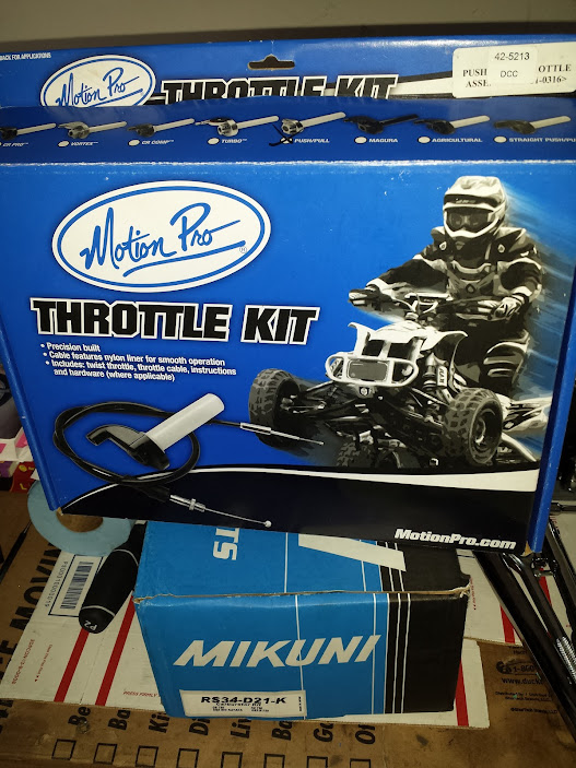

I got my Mikuni RS34 carburetors mounted last night and they are beautiful!  I was really worried about having to struggle to install them, but it actually went pretty smooth.  I spoke with Ken at Cycle X and he suggested using K8 boots on my bike.  So I contacted Vintage750 in Canada and purchased a set of their reproduced K8 boots.  Good luck trying to find them anywhere else.  The only thing that I ended up doing was spraying a little WD40 in the boots and the carbs popped on without any drama, no heat, and no soaking.
I used Motion Pro’s throttle cable assemble for Mikuni carbs.  I greased the lines and they work flawlessly.
1976 CB750F (915cc) Super Sport: http://forums.sohc4.net/index.php?topic=142578.0
Re: Bigsam302's 76 CB750F w/GSXR Forks: Project Helen - Finally, progress!!!
« Reply #116 on: September 02, 2015, 04:52:40 PM »
Sam,
HOLY COW! THOSE RS34s look cool!!!  Are you using clamps with the carb boots?
Is that throttle specifically made for use with the RS24s?
I have one of the Motion Pro Variable Rate Throttles (Model 01-2657) that I was planning to use on my 750 with either RS34s or CRs:
http://www.motionpro.com/motorcycle/tools/featured/revolver/
It has push-pull cables like yours.  I wonder if I will have any issues mating it to RS34s if I go there.

« Reply #117 on: September 02, 2015, 05:06:19 PM »
Sam,
Don,
Yes, I am using clamps on my boots.  Vintage750 sells a set of black clamps that go on their boots.  They look nice and you can barely see them, unless you are really looking for them.  I am very happy with them.
The set of Motion Pro that you have are way better than the set that I am using.  Mine is a universal kit that works with Mikuni.  I will try to find out which one I actually have.  I ordered them a while ago when I first started to wrap my grips.  You should not have a problem using them at all.  The set up is pretty simple with the push/pull cables.
Sam

« Reply #118 on: September 02, 2015, 05:20:20 PM »
Don,
Here is the actual set that I got. http://old.dimecitycycles.com/motion-pro-push-pull-throttle-assembly-kit-for-mikuni-racing-carburetors.html
Like I said, yours is a lot better than mine.
Sam
