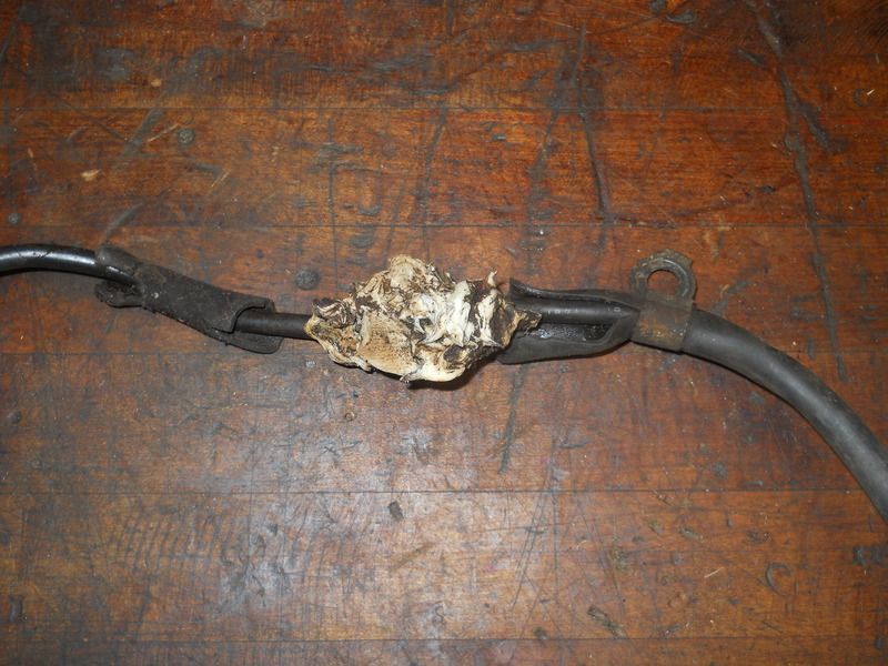

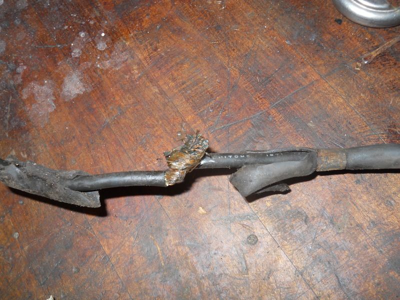

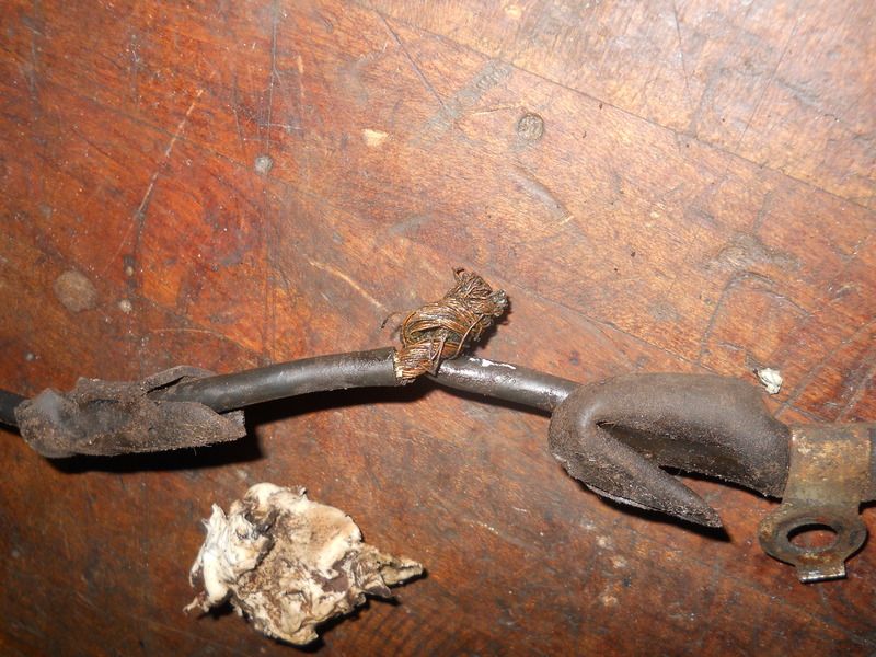

So I was doing some cleaning to the wiring harness and connectors when I remembered about the cable that runs from the starter solenoid to the starter.  When we took the engine out there was a big glob of caulk on it.  I decided to pull off the glob and see what was underneath.  Looks like I will be getting a new cable.

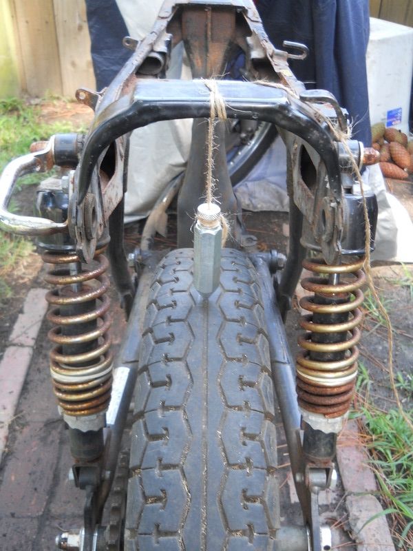

Moving right along.  Working on the rear wheel in regards to the spacer size needed to center the wheel and ensure the sprockets are aligned.  There was another guy who put comstars on his 350 and said they fit up just fine.  However, based on my findings I don't believe his wheel was centered.  I am willing to bet that he probably just eyeballed it and thought he was good.  Well that doesn't really work for me.
Leveled the bike and took some measurements and found the center of the frame.  Made a mark and tied my plumb bob to it.
Stock wheel shows to be centered in the frame.
With the comstar wheel on using the 350 spacers and the axle nut tightened until it bottoms out on the axle there is a gap.
It was hard to get in there and get a truly accurate measurement, but it was real close to 1/8".  So I stacked a couple of washers I had and fit the wheel again.  This time with good results.  The axle nut tightened fully and the wheel was centered.
Now for the big test.  Do the sprockets line up?  I got my trusty straight edge and laid it next to both sprockets.  There are no gaps between the sprockets and straight edge and the wheel is centered.  I am calling this a success.  Now I just need to get one of the longer spacers I have cut down to the correct size for my application.  By my calculations the spacer size on the right side should be 37mm (mine actually measures 37.25mm)

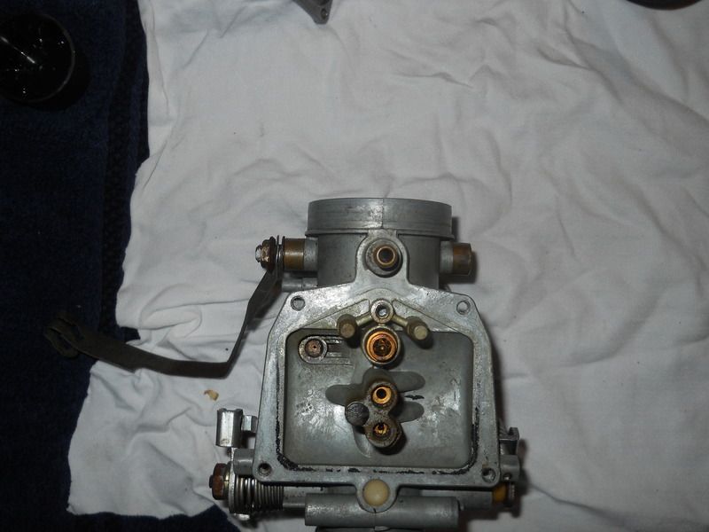

Well today is witchcraft and voodoo day.  I am going to clean and rebuild the carbs.  I bought extra o-rings when I built the wife's bike so I should be able to get these back together today providing the internals are good to go.
When you pop the top this is what you see.  Nothing spectacular, just a spring and diaphragm.  Those come out fairly easy, but since it has been a while since they were opened you have to be gently with the diaphragm so you don't tear it.
Inside are these parts.  I don't really think it is necessary to take it apart, but since I am in there and want to make sure everything is nice and clean so off they go.
Now flip the carb over and pull the float bowl.  This is where it usually gets nasty and stinky.  Old gas reeks.
Pull the primary and secondary jets.  They took some work to get out.  The o-rings were damn near welded in there.
Pull the float and bracket for the float need and seat.
At the top you have the float needle and seat.  Then below that is the secondary and then the main emulsion tubes.  Underneath the black rubber piece is the pilot jet.  The emulsion tubes have to be tapped out from the other side even tough it looks like the main can be unscrewed.  It doesn't and if you try, you will rip off the tabs.  I use a soft wooden dowel to tap them out.  Sometimes they don't like to come out very easily, but luckily I didn't have much of an issue.  After they are out you just have to inspect the tips carefully to make sure they didn't get damaged during the removal process.  Pry up the rubber plug and unscrew the pilot jet.
Everything cleaned and ready for assembly.  The emulsion tubes have tiny holes in them.  Just about every hole was clogged and the holes in the pilot jet were clogged as well.  The main and secondary jets were really restricted as well with built up varnish and gunk.
Unfortunately, I forgot that I had to use one of the o-rings from the extra sets I bought on the wife's bike because I accidentally slung one across the garage when I was installing it.  Also, I didn't have any spare o-rings for the idle mixture or the float bowl drain screws so I will have to order those as well.
I may have an issue though.  While I was cleaning the carb bodies I noticed they are not the same carbs.  One is a 722A, which is correct for the bike.  The other is a 726A, which I have no idea where it is from.  They look identical and the only difference I found between them was the main jet size, which could have been changed by a previous owner.  I put the correct size main jet back in when I assembled it though.  Additionally, I see a lot of references that group the two together.  I posted a thread in the carb section on the Honda Twins site inquiring about it.
