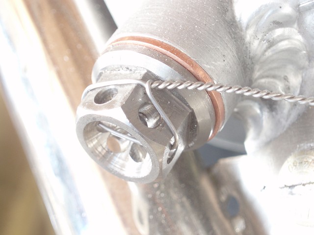

in the meantime I will have enough time for drilling screw heads for the safety wire.

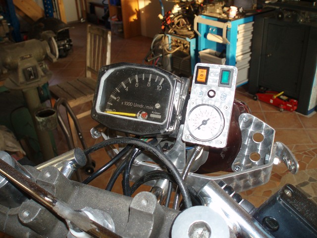

kröber speedo, oil pressure gauge, ignition switch and light switch

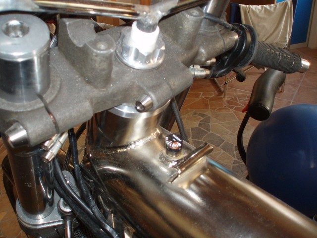

festo airpressure gauge for the frame tubes (between steering tube and fuel tank bracket)

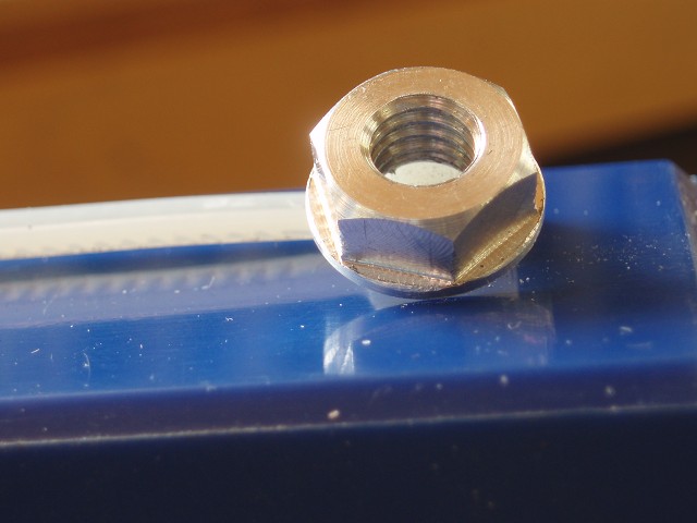

when it lacks a lightweight M6 nut, I have to do it by my own (aluminium)

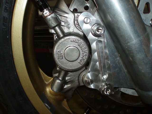

lockheed calipers with mounting plates for the 315mm rotors (yet the calipers do have steel pistons, it will be an absolutely must to replace them by aluminium ones  ;) )
have a nice day
mec

That looks fantastic mate, what's the air pressure gauge for? I like your "dashboard" layout, nice and simple.
I can understand your frustration regarding the time you need to wait for your painter to finish your stuff, but unless he's a "hobby-ist", he's probably got other work to finish too?
Anyway, isn't it winter in Austria? I would have thought a snowmobile would be more practicle this time of year? Cheers, Terry. ;D

sorry if i missed it; where's the tach from?
the air volume of all frame tubes are in contact all together. the air pressure gauge indicates if there is a fracture to come (hopefully not).
yes, it is winter  in austria. cannot tell you, how much I hate winter.
for (my) clarification: the speedometer shows rpm, the tach shows speed. is this right?
there is no tach. speedo is a german product, we call it "kröber drehzahlmesser". but I think, it is no longer in production.
