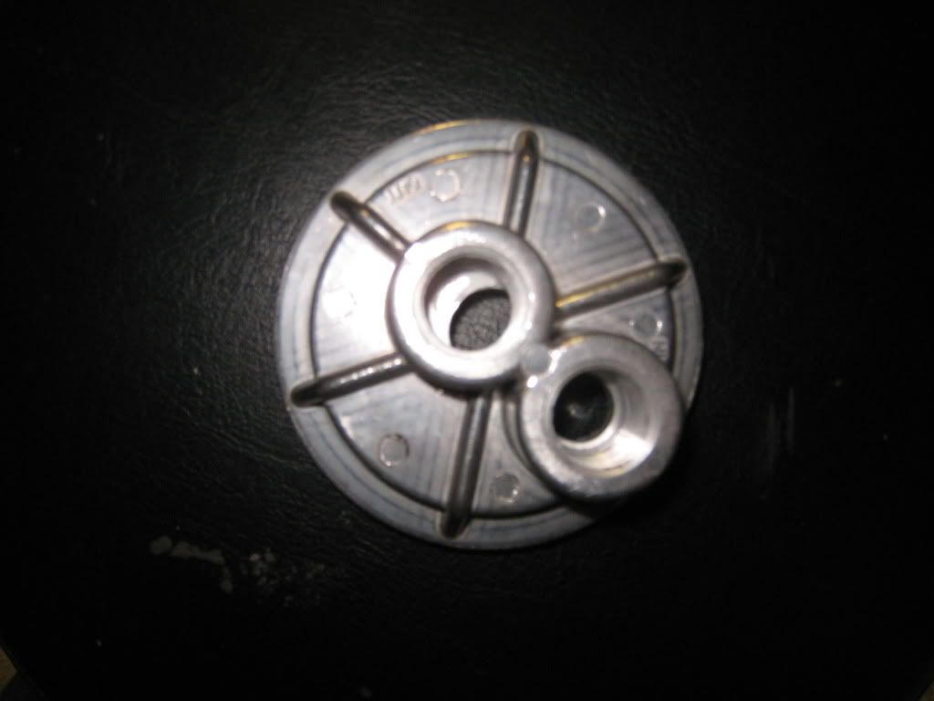

This will become the oiltank :) :)
6$ adapter (for GM filters)bought on ebay to add extra oilfilter on the return line :) :) ;D Have to fabricate the connections, but should be easy.
