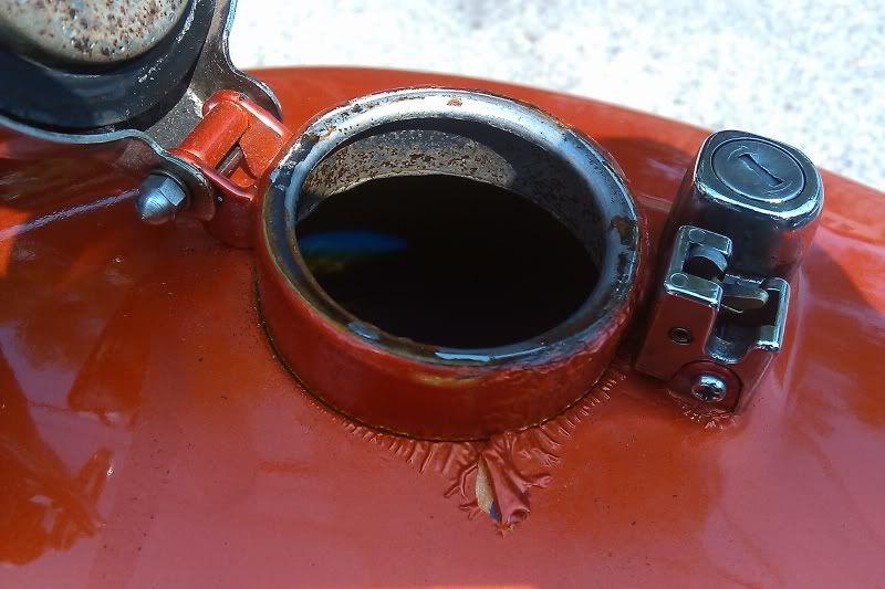

Even though it is blazing hot here today (and has been for a couple of weeks), I decided to ride to work.  Beautiful ride this morning....had to turn to reserve when almost there, so I pulled into the filling station before heading to the parking lot at work.

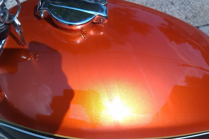

Fast forward to 3 o'clock today.  I walk out and see this...
The heat had apparently made the fuel expand and it seeped out of the cap and onto the paint....lifting it and leaving streaks down the side.  I just about fell to the ground.  I didn't overfill the tank.  It was filled up to about the bottom of the filler neck while on the side stand like I usually do.  I have never had fuel overflow like this....although I don't think I've ever had the bike sitting out in near 100 degree heat before.
I just had this paint job done this spring by a very reputable guy here in town who is pretty well known for his work.  He did a great job and it looked sexy.  Great color match to the original...hand painted pinstriping.  I had some lifting issues under the cap which he said may be normal, but they stopped at a certain point and I didn't worry about it.
I'm going to e-mail him with the pics and ask him what can be done.  Maybe he can respray the top part?  I don't know.  I got a heck of a deal on the paint job.  We basically bartered the job and it cost me $100 including materials....so I don't feel I can complain to him very much.
I'm just sick over this.   :'( :'( :'( :'(

The clear can probably be buffed out. However, the painter did not put a hardener/sealer on the lip of the tank fill tube, allowing fuel to get under the paint. This is very common. You will notice a different color ring around the lip of the filler of most tanks. This is the sealer. I painted a Royal Enfield with terrible fuel cap leaking problems a year ago, and that paint still looks perfect. I would contact your painter. He would only have to touch it up and re-clear. The decals can remain in place.

I just e-mailed him.  He's a good guy and will help me out hopefully.  I know the top part around the cap is toast....maybe I can come up with some creative way to hide that?  I'm just hoping that I can buff out the streaks.  I didn't go wiping it off right away for fear that it might wipe the orange tinted clear off.
The paint was two part (metalic silver underneath with orange tinted clear) and I believe it was house of color auto paint.

Man, that is sad. I had the same gut feeling when I saw pin holes show up under my paint job...twice. And that was after a tank liner. Glad that is behind me now. Good luck with yours. Sounds like you got a good painter there. Is that rust in the tank there?
There is a tad bit of surface rust around the inside of the filler tube and on the bottom of the cap, but nothing serious.  The tank is largely in really nice shape.  I did a de-rusting job last summer that seems to have helped it and it has stayed relatively rust free.
The brown around the edge of the filler neck is actually remnants of "hard as nails" nail polish.  That is what the painter told me to do periodically....paint a bit on to keep paint and fumes from getting up underneath and lifting the paint.  I found that the nail polish tended to chip off and fall into the tank after a while, so I stopped.  I did have a couple of little spots lift on the filler neck, but it stopped after just a few millimeters.

Next time get some Novolac epoxy and seal that area one time and be done with it. Actually the painter should have left the edge of the paint 1/8 of an inch below the lip, and used the sealant up to the lip. The top of the filler should remain raw metal, if possible.

The heat didn't make the gas expand and flow out of the cap - it was the fumes.  But the heat definitely exacerbated the fumes.  The next time it's out in the sun, stand to the side and look at the gas cap.  You can see the fumes coming out.
I used to cover the tank with a cloth to keep the sun off it.  But when I pulled off the cloth the whole top of my tank had the clear coat start to get milky.  No big deal for me since I just rattle-canned it, but no cloth after that!
Anyway, just thought I'd mention that it wasn't the gas itself that seeped out, but rather the fumes that did it.
[EDIT:]  Nevermind.  I didn't look at the photos well enough.  Definitely looks like gas spilled out.  Fumes can also mess up the paint, but looks like actual gas in this case.  Thanks to Gordon for point this out to me.
And I think freshly painted tanks (within the last year) are most susceptible to this.
Huh?  How did the fumes pour down the side of the tank and mess up the paint all the way down to the bottom?
Excessive heat and direct sunlight will cause gas to spill out the top of a completely full tank.  The exact same thing happened to my 550 less than a week after painting it.  Luckily it was just a cheap rattle can paint job so I wasn't all that pissed, but it was definitely liquid gas spilling down the side of my tank when I went back out to my bike.

I would not even think about paint until all rust was (properly) taken care of either by me or my painter. Nail polish is just a bandaid. The painter should make this good he did not seal it. did he bake it? did he tell you not to use it for x amount of time. Has this ever happen to him before? I would be nice at first and see what he does. but if he did not make it right I would have to get another tank because that one would be up his ass

Regarding the rust, it is not nearly as bad as it looks in the picture.  There is no rust at all in the main part of the tank.  There is a bit of very light surface rusting there on the top that appeared right after I de-rusted it prior to having it painted last winter.  I think it looks bad here because of the direct sun I was in to take the pic.  This paint issue wasn't caused by rust.  It may look like paint seeped out of the joint where the filler neck is welded to the tank, but that is not the case.  That joint is totally solid.  the gas seeped under the cap and ran down....then collected in that joint and sat.  That's why the paint failed there I believe.
Yes, it was definitely gasoline that came out.  It was dripping down the side of the tank.
I did hear back from the painter tonight and, like I thought he would, he offered to redo the tank this winter once riding season is over.  I really was looking to just get some advice from him as to what I should do about the streaking...so i'm thrilled.  He told me that he's never seen paint be this susceptible to gas before and that it shouldn't be like this.  So that is VERY good news.  He is a pretty good guy and is pretty well respected in the vintage scene here I think.  I'm sure he probably doesn't want a tank he painted looking like this while parked at a vintage night around town....that may have something to do with it too.
+1. Nail polish, you've got to be kidding! The painter needs to make good on this or find someone else to paint.

"The paint was two part (metalic silver underneath with orange tinted clear) and I believe it was house of color auto paint."
There are a couple of things that throw up a red flag for me.  One is the price, another is the nail polish, and the third is the "orange tinted clear".  Candy colors are transparent like hard candy and shot over a solid or metalic base color.  The base and the candy create the final color.  The paint job isn't done after the candy is shot.  The entire tank needs to be cleared afterward and buffed smooth.  This isn't the 70s anymore.  Modern paint jobs need to be clearcoated.  The clears can be tinted but this is usually for UV protection not to create the final color.  Was the tank cleared after the colors/striping were done?  It only cost $100, so you won't be out that much.  I would reconsider using the same painter to redo the tank.
Scott
