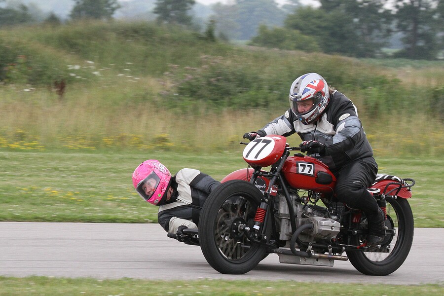

Seth,
I imagine you will get an appreciable power gain going from the Ural 750 to the R100 motor - an approximate 160% increase according to factory specs at the crank (70 vs 44).
I haven't had much experience with BMW flatheads, other than riding my buddy's R50/5.  It takes some getting used to when you rev the motor and feel the gyroscopic effect pull the bike to one side.  I'm sure you will feel it more with the larger R100 motor.  If you don't mind, post some pics of the BMW/Ural build as it progresses.
Re: The Quest for Brakes and Suspension: GSX-R Treats
« Reply #352 on: July 29, 2014, 10:25:53 AM »
That gyro is mostly due to the output shaft being on the right side, tied to the right-sided final drive. Also, the cylinders are offset front-to-rear increasing this gyro. Like righthanded rifling in a pistol actually. That is why many of their bikes came with dampers I'm told. Deceleration and the gyro, hmmm, interesting steering effects.  :)
I wonder if the two-wheel drive of the side car combined with the weight of the side car balances that gyro effect.

Not really great iphone photos, but I wanted to give you guys something before I went back to work. Honestly, I've pretty much just been riding the ural for the last three weeks ;) With the clip ons and the pull on the Mikuni's, the bike is pretty tiresome on the hands and forearms.
The best training for that is to ride more, not less!  This is a beautiful bike, you did a great job on it.
