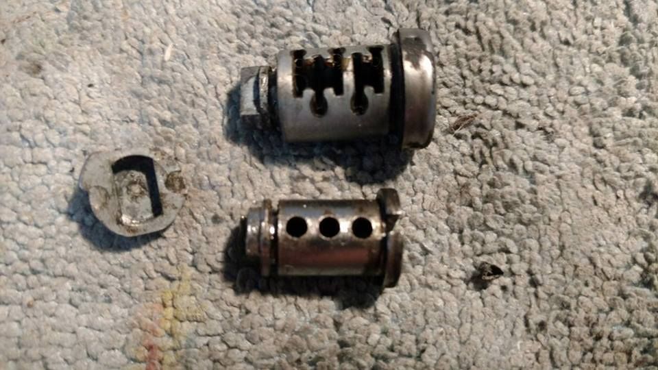

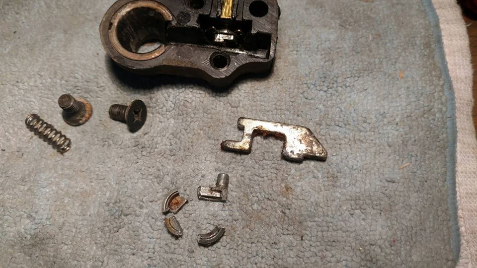

 Just found out the the lock/tumbler on my '73 CL350 is busted. There appears to be a ring or cam of some sort that moves with the key/tumbler and is supposed to release the plunger. Mine's in about four pieces.

Actually, you do not have to remove the circlip at all. The "cam" part is the only part you need to replace. This provides the link between the "lock" and the "latch". This cam just slips into place into the notch on the latch pin. The latch pin, cam, and latch spring are "captured" when the latch is bolted back on to the frame. All you need to do is harvest a cam from a donor latch and you can leave the key tumbler as is if you like, especially if it still matches the ignition lock. The cam has a square hole that fits over the square end of the lock cylinder and a pin that fits under the cutout on the latch pin.

 Well, dang it! I found a lock assembly in my stash and disassembled it only to find that the tumbler and cam are completely different. The cam won't fit the old tumbler (and I've now removed the pins) and the key won't fit the later tumbler, even with the pins removed (completely different style of pins). Now I have TWO worthless seat latches!

 On the later style, it's not an empty slot. There's a key way in there. But, yeah....I see how you can remove the brass pins and just use it as a latch and not a lock.

 The later style had wafers, for lack of a better term. The earlier lock had three brass pins. They're totally different. I would have been OK with just a latch, since there's nothing really under the seat of a CL350 to steal other than the battery.
