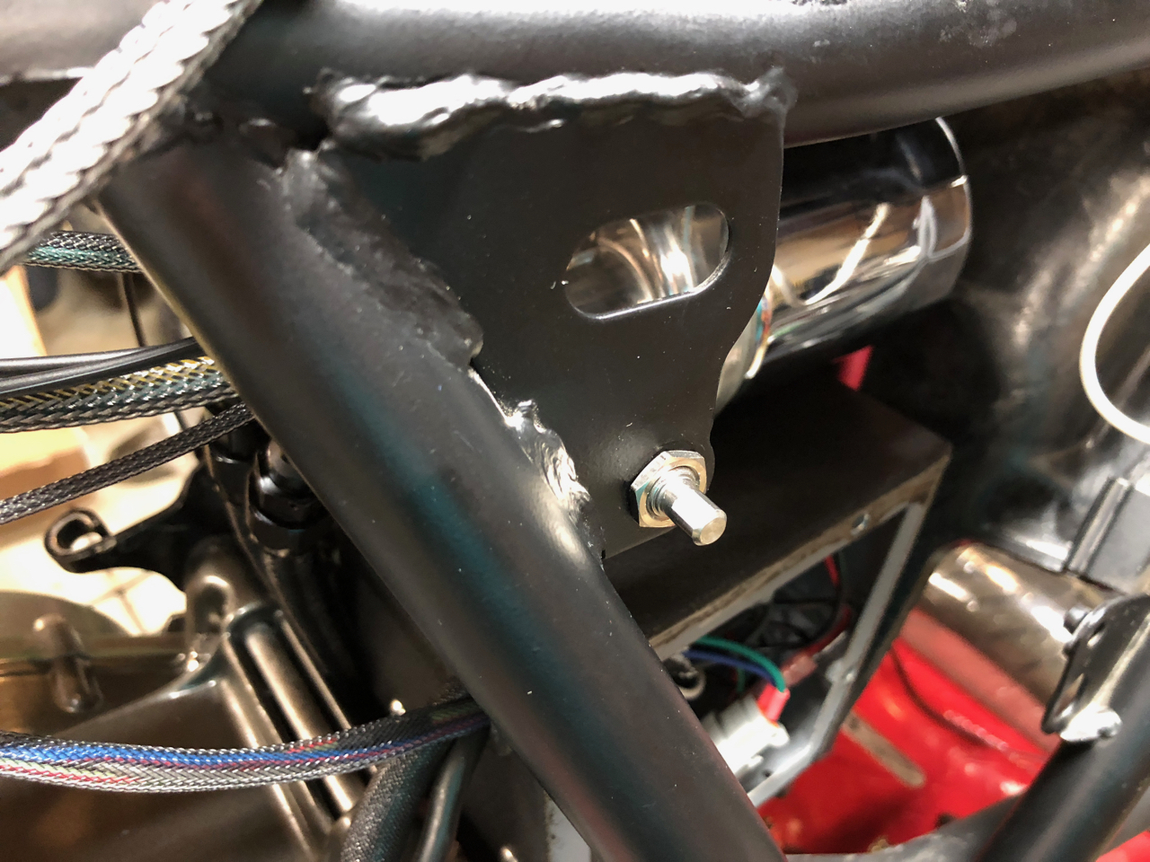

Motoscope looks great.  What’s your plan for the speed sensor?
I’ve got something in mind. Having a part made at the moment and will have an update as soon as it’s back.

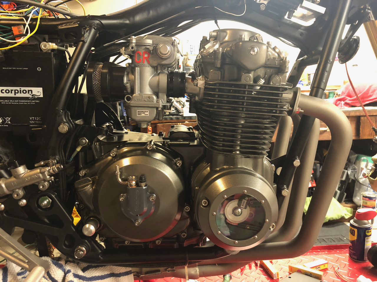

Few updates:
Engine is just about ready to start. I am going to wait for the wheels to be back on but aside from some wiring and hoses it's ready to go. I had to reset my gaps for the cam after reviewing some notes. I got the C5 all wired up. Just need to finish wiring the coils and connect the plugs. I also decided to get the rotary switch so I could select different timings. I drilled out one of the old mount points for the original electrics tray. I will get a good looking knob on the post and work it in with the eventual side covers.

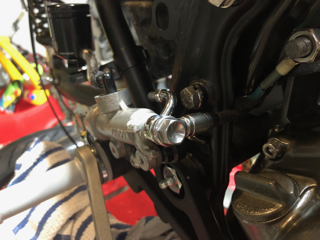

I also picked up a low profile banjo bot for the rear master. I really like how this just dives out of the way and hides the wiring.

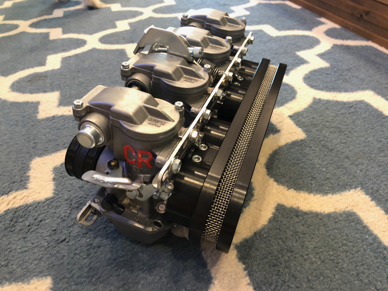

And finally, I got my airbox from Cognito! I really like the look and have a ton of clearance by the frame. Got it mounted and the carbs tightened down.
I got my hubs back from being coated and got them down to Buchanan's to be laced up. Once I have those back I will get an Outex kit on them, mount the tires, and installed on the bike. That will probably be my next update unless the bracket for my speedo mount is finished before.

Hopefully that air box does not restrict airflow.  You will want decent air volume to feed those carbs.

Agreed that the airbox looks good, BUT it serves a critical function.  I don't care if the box looks less attractive if it tunes easy and makes good power.
My hope is I get both but if performance drags because of it you'll see something else on the bike.

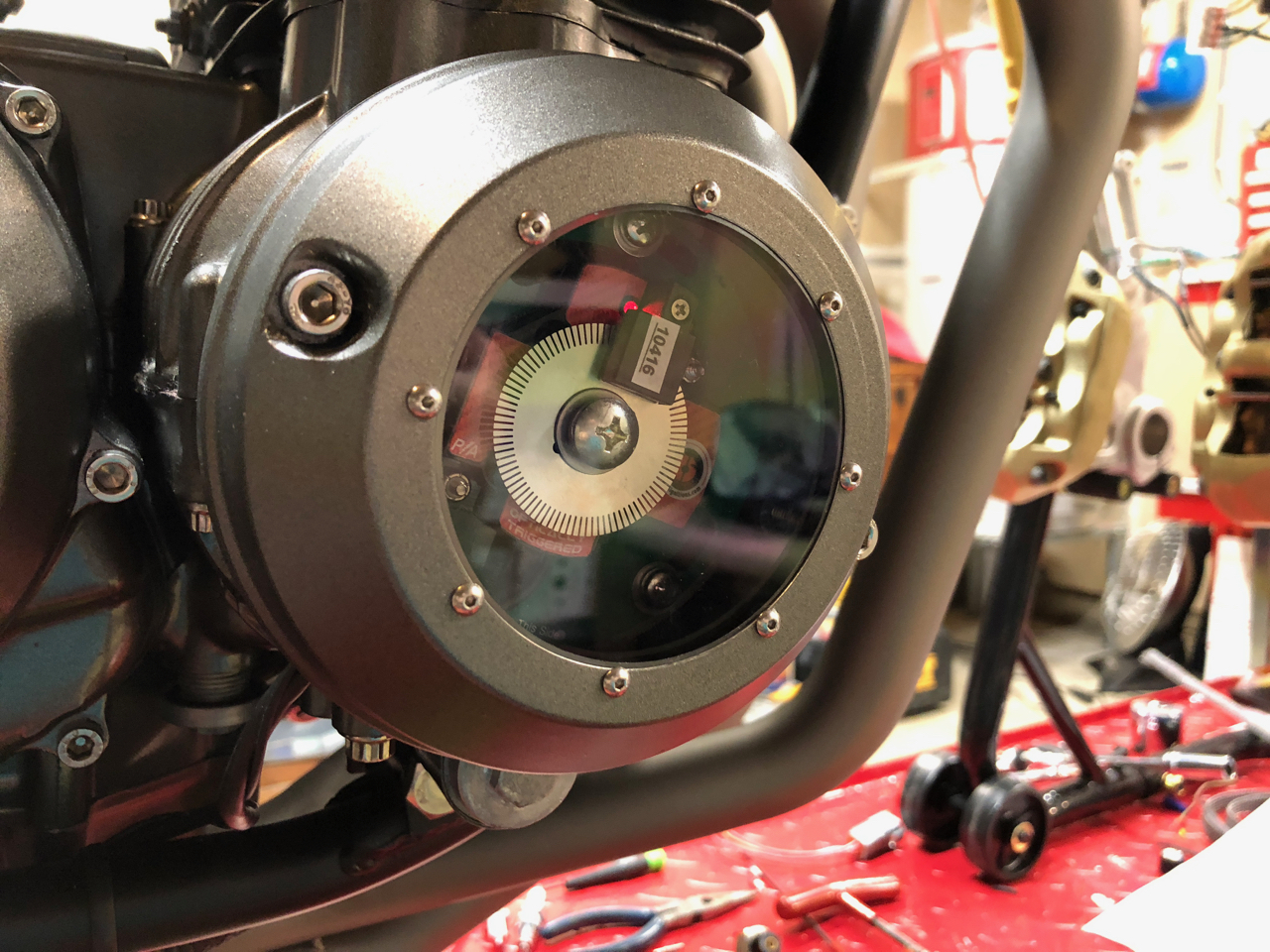

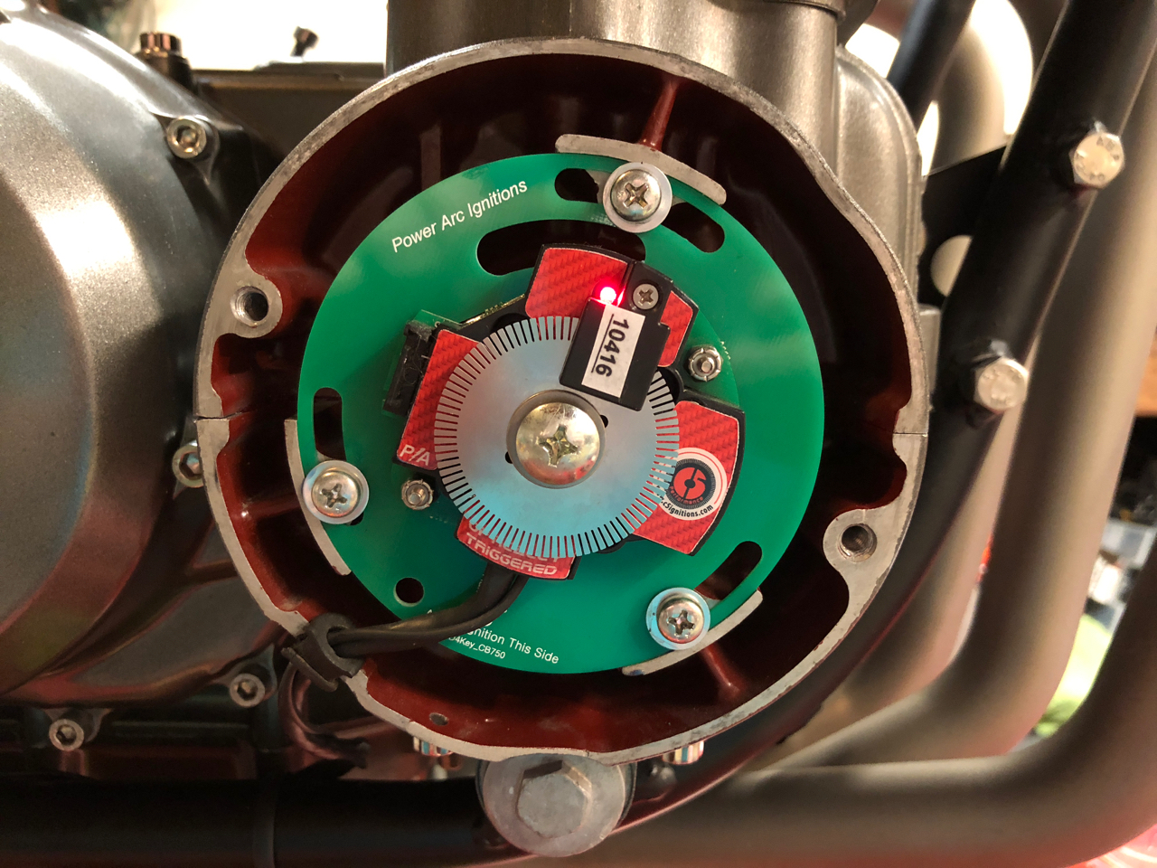

Does the C5 ignition use the stock spark advancer?

If the jetting is not far off from the factory stacks you can swap between the air box and stacks to compare.  I ran CR29 and CR26 Keihin carbs on a CB550 and at one point I tried some great looking polished stacks.  After multiple jet changes my readings were all over the map causing odd behaviour.  I pulled them and went back to the factory stacks man what a difference.  Those nice looking stacks were all show and no go.

Nope...

And the current settings on the carbs are as follows.
MAJ = #220
MJ = #115
PJ = #58
JN = 448 #3 clip
Airscrew = 1 turn
I actually didn't set these. Carbs were setup by Powerbarn when I ordered them based on some engine setup I handed off. I have heard this thing tunes like the pods which is what the carbs are setup for at the moment. But the proof will be in the pudding when I get everything running.

Sexy.  Should have known no stock spark advancer when you mentioned the adjustable curves.

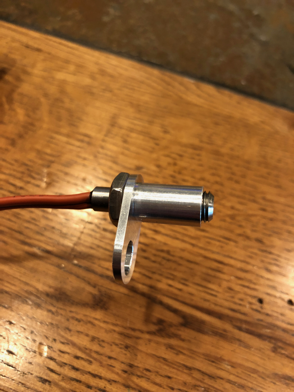

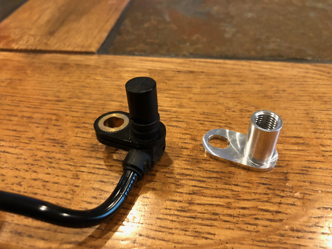

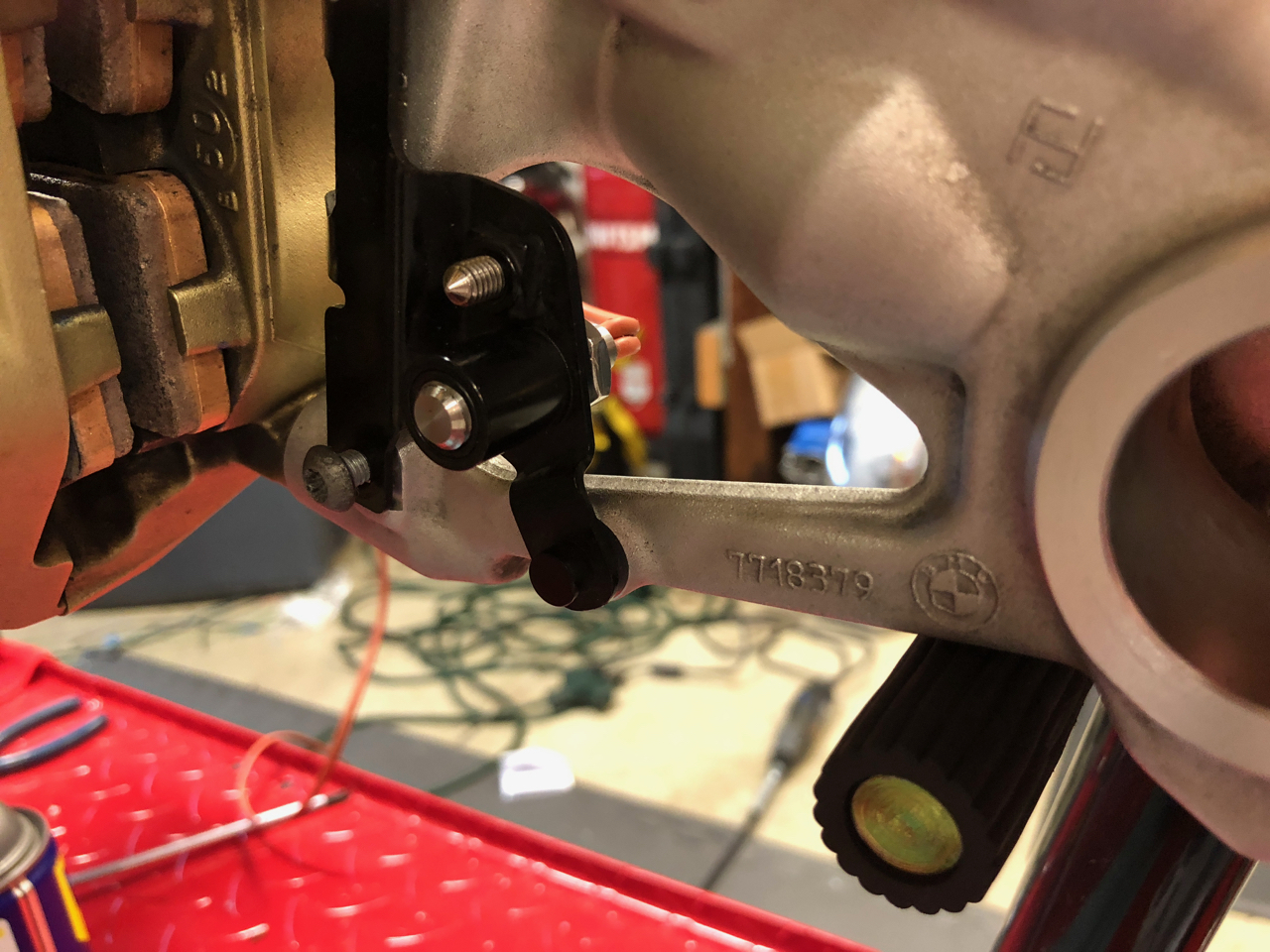

So, one of the first things that drew me to the BMW front end was the ABS Sensor mount. The Motoscope Pro for the R9T uses it to get speed readings. After a little research I figured out the the stock ABS sensor is a Hall Effect unit which will not work with my Motoscope Pro. I need to run their dry reed sensor. I knew I could still use the location to mount the sensor, I just needed to create a bracket...
Well, I designed one (using the original sensor as the base) and got the bracket made up. I was able to pick it up today. I am super happy with how it turned out. It looks factory in my opinion. I will use the ABS ring (slightly modified) to mount the magnets on.
This is the stock R9T sensor and the bracket that I had made:

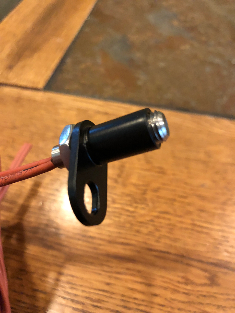

I picked up the beefier sensor from Motogadget. It is a 8Mx1.00. It is also a little longer than the one that comes with the Motoscope. I needed the extra length.
I tagged the bracket with some paint and it blends perfectly with the other piece that mounts to the fork lower:
Now I am working on the fitting on the fork. I will get some Flexo PET on the wire and won't tighten the sensor down until I can set the distance to the magnet. I have an additional bracket that mounts on the caliper to help the routing of the wire. It then clips to the brake line up into the headlight bucket:
