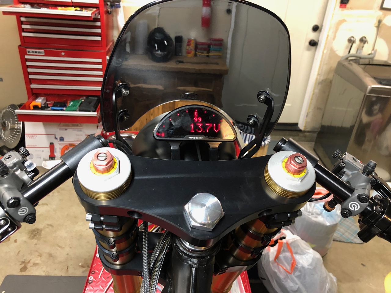

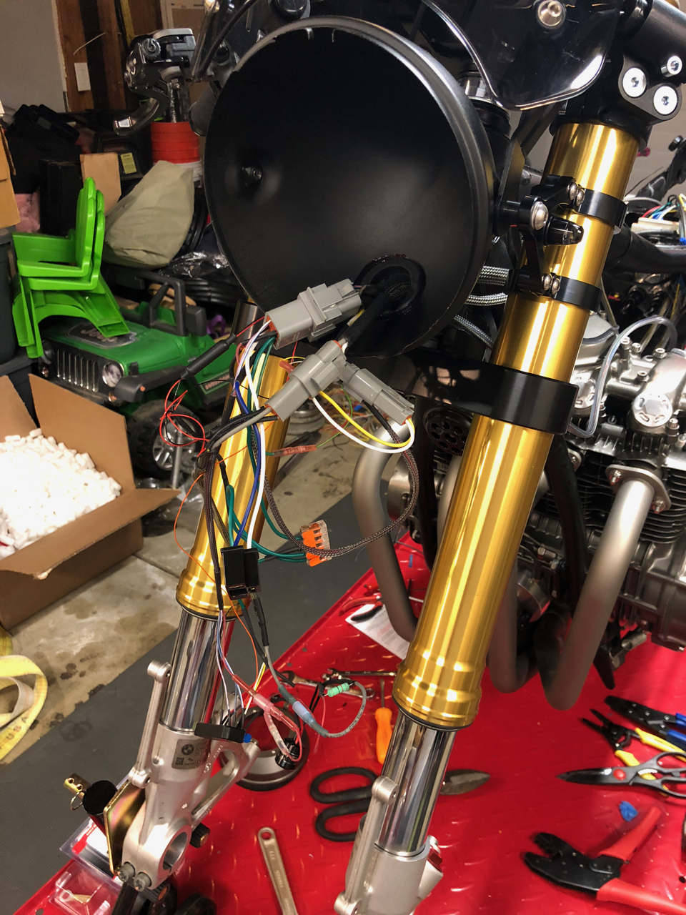

Few little updates. Getting the front back together and getting the wiring back to where I had it. I was able to get about 80% of the 12v wiring back together and rough test some of the new pieces. Needed to get a few more little odds and ends before I button the electrical up though so those are in the mail.
I also repainted my bucket to match the frame a little better and found I nice sized grommet to fit the hole decently so the loom is protected a little better.
And still working out the heights and positions of everything. I will tighten everything down once the bike is back on the ground.

That motoscope is nice! I opted for the Chronoclassic for a more vintage look and because I tend to ride more in daylight (since LEDs can sometimes be harder to read with sunlight glare), but this looks really clean.

Motoscope looks great.  What’s your plan for the speed sensor?
