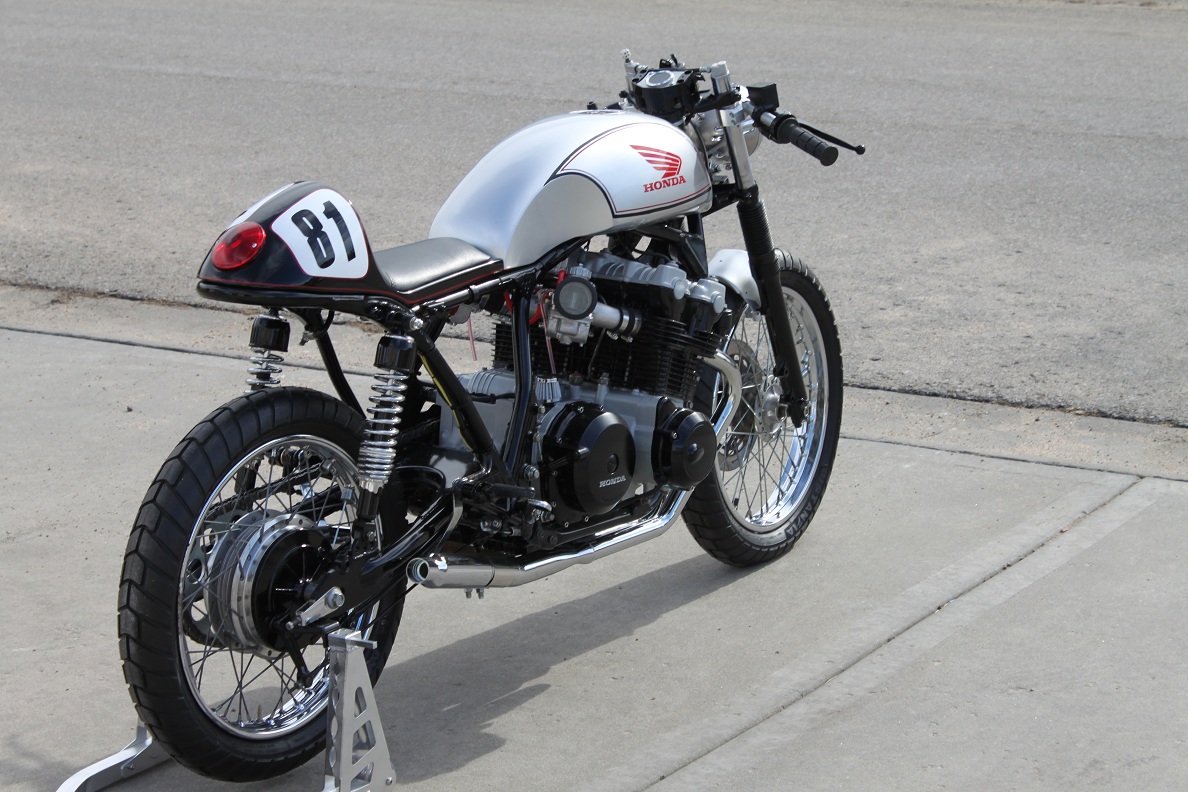

Little bit of an update:  Dry fitted the tank and tail(need to make the frame loop and support)
Untitled by bailey_james62@ymail.com, on Flickr
Ordered rearsets:
And made a support system for the carbs since the intake tract is so long:
