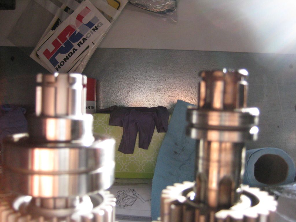

Damn, this transmission output shaft oil seal (91205-426-013) is really elusive. I called around half a dozen bearing supplies in my area and there's nothing that can fit. It's 36x57x13 and even if I were to skimp on the thickness...like all the way down to 10mm, nothing. ALSO, and I was getting a little creative here, if I were to turn down the output shaft a bit to fit a 35 or 34mm seal, still nothing.
Even if I were to find a seal the right size, most of these don't have an outer lip to prevent it popping out.
I'm on the CMSNL watch list so we'll see what happens. Anyone have other ideas? I was already looking at Kawasaki's and Suzuki's to see if they had anything that would fit. The Honda Pilot has a seal that's super close in size, but that's discontinued also, haha.

The collar that presses on next to the bearing could be replaced with a CB550 collar and use the 550 seal. Same seal OD. Those collars have a thin o-ring inside, be forewarned not to lose it.
What about an aluminum plug as thick as you want, even full 13mm, same OD as the seal, with a groove cut for an o-ring to seal against the cases, then in the center of it use a smaller OD seal with the right ID??
***Edit; I just checked the collar dimensions between the CB550 & 650. As far as I'm concerned they're the same part. Obviously the 650 seal is wider, but I see no reason why the 550 seal wouldn't work in a 650. Not sure why Honda used a larger (36mm vs 33mm) seal ID on the 650 if the collar is the same. One of those Honda engineering voodoo things.
I wouldn't be concerned about the narrower seal, with my 6spd gearbox the 550 seal doesn't even sit all the way inside the cases and it's fine. I did make a seal retainer to hold it though.

The 550 seal has an ID of 33mm while the 650 has an ID of 36mm. Are you saying turn down the collar that's on the shaft to fit the 550 seal or just push on the 550 seal? That shaft with collar and bearing from Honda is two different part numbers so I don't think the collars are the same.
I'm not against a plug to fit a popular seal, I'd have to get that made as my lathe skills aren't that good.

I know Honda claims two different seal ID's but I measured both the 550 & 650 collars and they are the same. I will double check, I have both model countershafts in my gearbox collection!
Re: Patina Hyena - Dave's '78 CB550K Cafe Build Thread
« Reply #1130 on: October 10, 2016, 05:48:17 PM »

Thanks Brent, haha must be nice to have all those parts laying around. The only 550 shaft I have is all buttoned up.
I've been thinking about a plug or really more like a sleeve/collar that could possibly work. It would have to be something thin. Something to accept a seal with an OD of like 50mm. I don't know how small of a seal I'd actually want to use, I'd imagine keeping the OD no lower than 50mm would be a good thing. This is mechanical re-engineering that I really have no business doing, haha.

Ok so I think the easiest solution would be this:
Buy or have made a thin sleeve that fits over the output shaft with a diameter that can accept a seal with a specific ID. Like a 40x57x13 seal and slide a 2mm (wall thickness) sleeve onto the output shaft. Maybe red locktite it to the shaft.
Also the seal would have to obviously be a double lip rotary seal made of FPM/FKM (Viton)

OK Dave, sorry I measured two different 550 collars yesterday.....You can see the 650 counterhaft on the right above. The collar measures 36 x 14.4mm compared to 33 x 11.75mm for the 550. The 650 seal is a much better piece, has a locating rib and the collar it rides on has an oil drain hole.
The 650 shaft is longer than the 550 but the 550 collar could still be used on the 650 shaft with an alloy spacer between it & the bearing, then the 550 seal could be used. Just another option. The CB360 collar shares the OD of the 550 and is much wider, would likely work as is.
From experience I have found Honda parts will become NLA and after a period of time a new run of parts becomes available. Certainly this may not always be the case in the future, plus you need something now.
