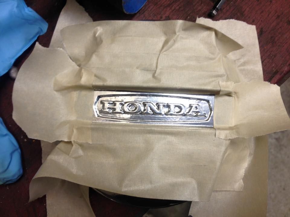

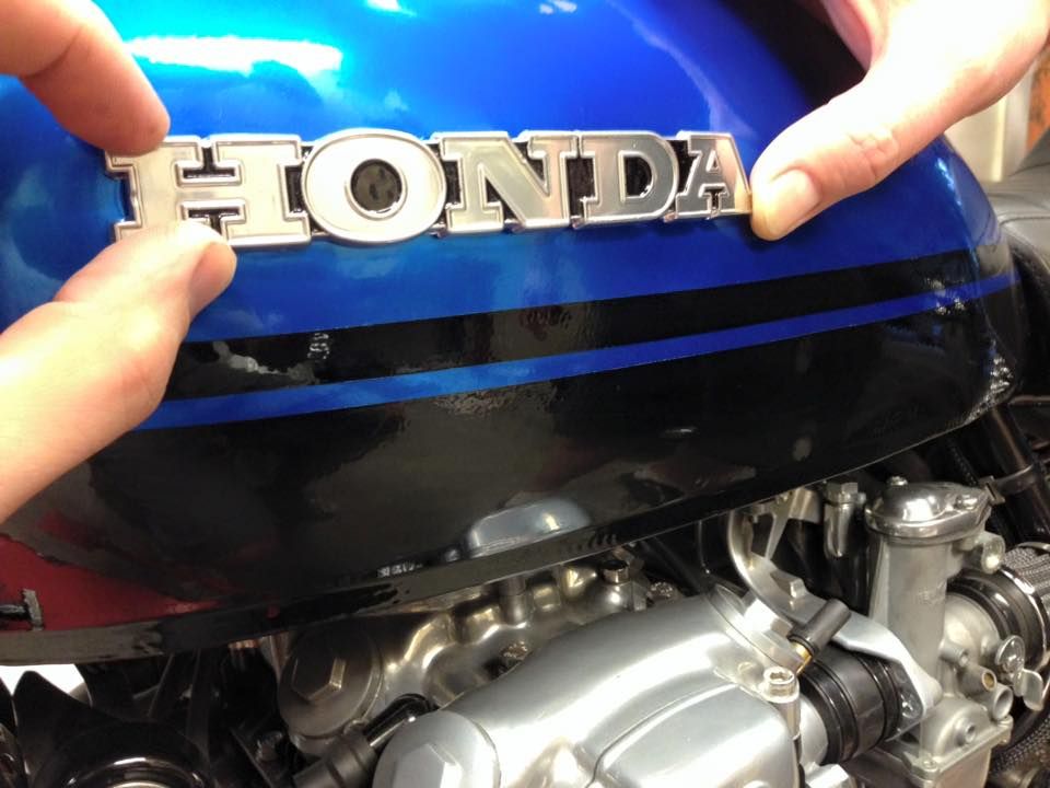

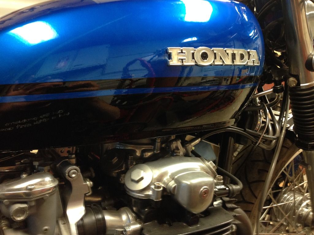

I powder coated mine. Media blasted, shot them with chrome powder and baked it, then shot it with gloss black, wiped off the letters and baked it a 2nd time. The first two photos show my points cover but it was the same process:
