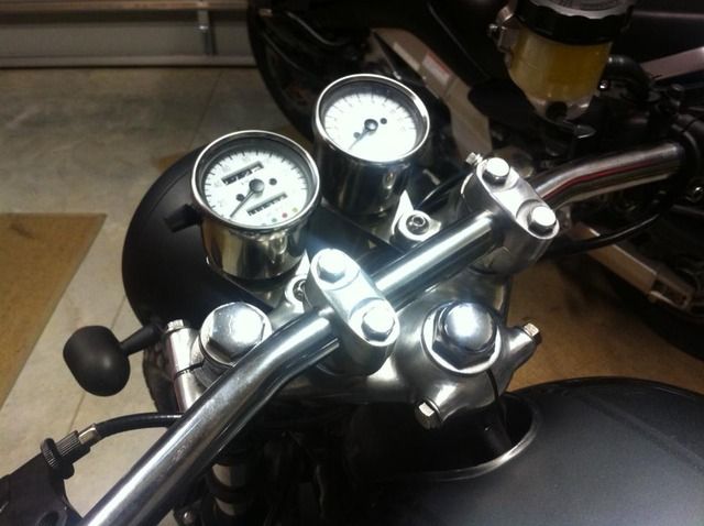

Removed the DCC billet top triple and clip on's and fitted a CB450 top triple and drag bars.
Made all the more fun by the fact I had been a good boy and previously routed the switch block wiring through the clip on bars to hide it all - never again!
Of course, muggins here puts it all back together and tries to start the bike - no start.
Ah yes, CB450 triples have rubber isolated bar risers and you do need to fit that little earth wire with a washer on each end from one of the riser posts to a gauge mount. All good now, took it for a ride through the local twisties and realised how much better I am on nice wide drag bars as opposed to clip on's.
Meanwhile the RFID chip under the skin of my left hand is turning the ignition on and off with ease.

It you feel the flat bars are an improvement in saving your back, you'll like Super Bike bars even more.  I did. ;) :)

+1
I did a 600 mile ride with drag bars once. Bought super bike bars afterwards and never looked back.

Yep, I was never a fan of drag bars, probably an improvement over clip ons, but not a patch on superbike bars. It's nice to be able to look in front of you without your neck being at 90 degrees to your spine........... ;D
