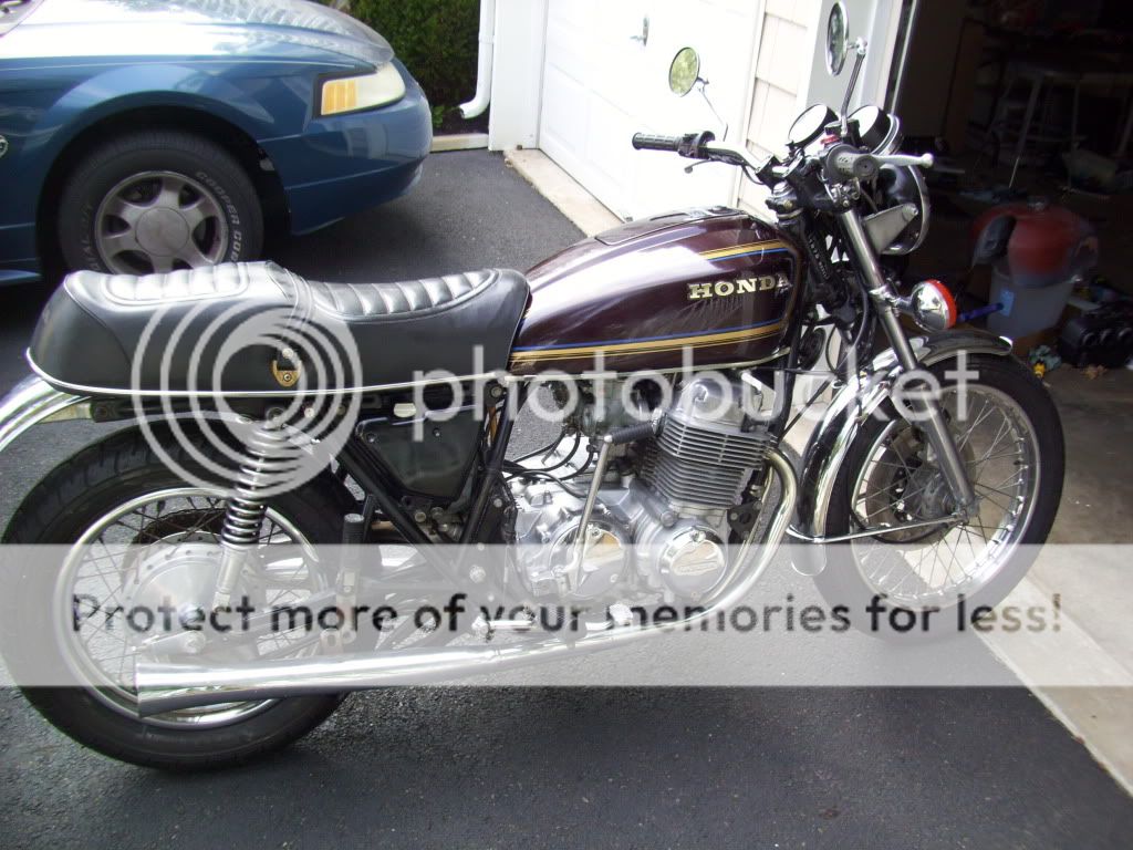

Re: CB750F seat on a CB750K some pictures ..
« Reply #4 on: August 12, 2010, 06:28:35 PM »
Here it is after 4 months of of cleaning a tune up and some minor  and some minor upgrades and repairs.
