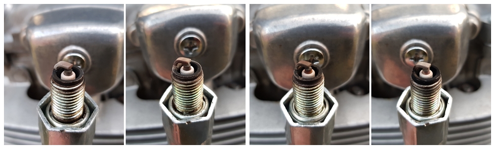

So, I took off the spark plugs after ~100 kms of highway driving (speed roughly 90...100 km/h, revs 5000...5500) to assess a/f mixtures in cylinders. I'm no expert in spark plug colors but afaik I'd say I'm pretty happy how they look. Spark plugs are NOS NGK D-7ES. I've got some spoiled (with rich mixture) NGK D-8EA(?)s to try out if I'm on the 'hotter' side with D-7ESs.

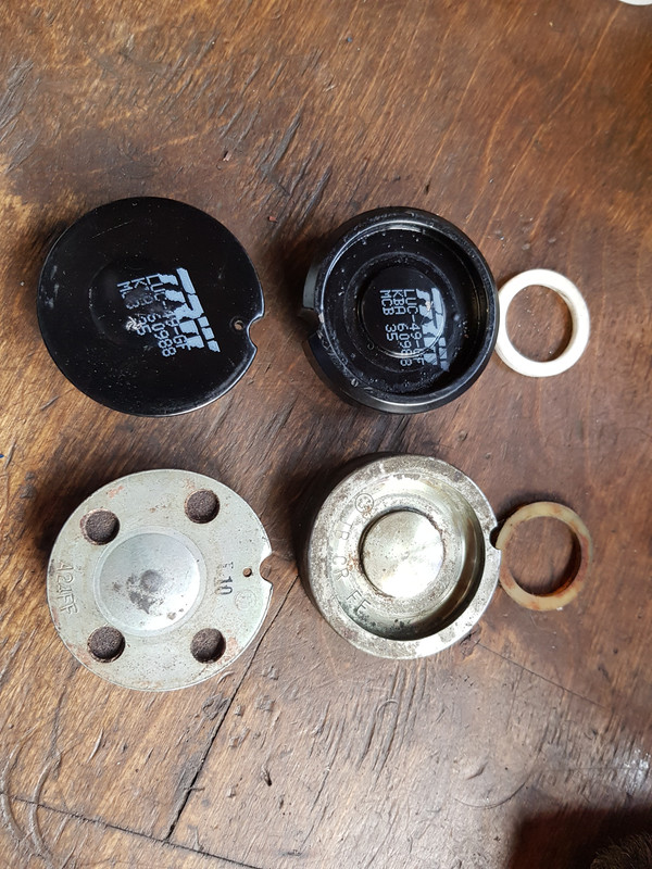

Took the brake pads off and I noticed that they have no chamfered edges as did the old have. Then I grinded chamfer to outer edges, applied some plasti lube and did a few km test run. Still in contact with the rotor. Had no more time to do a longer test run. Usually it starts making squeaky noises after about 15 kms. Also, new brake pad on piston side seems to be much looser than the original one, which was pretty tight in its place.
