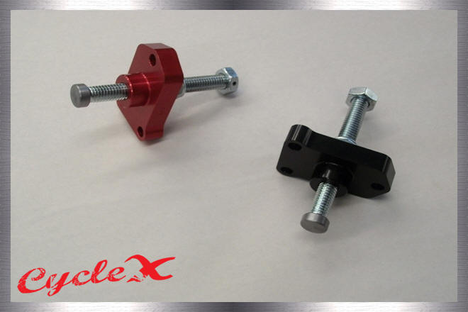

Cycle-X can provide both Cam Cover reinforced and HD tensioner.
http://www.cyclexchange.net/Engine%20Parts%20Valve%20Trane.htm
http://www.cyclexchange.net/camshaftpage.htm
I bot my HD tensioner from M3 Racing. Cycle X was not available at the time. It really quiets it down by supporting the nearly full run of the chain.

The whole thing, internal parts. The M3 part is a long slide that replaces the center wheel. The Cycle X part is about 1/2 of the way down on the 2nd link, with a yellow banner "Cycle X Racing Cam Chain Tensioner". It maintains the OEM design.
