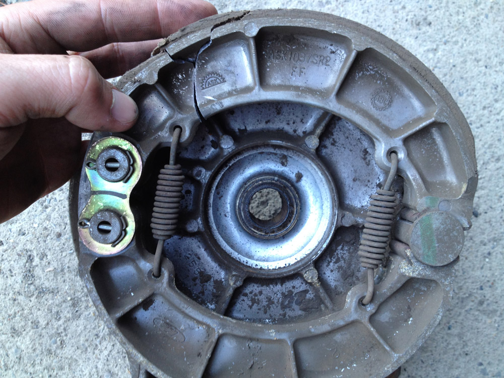

If you have to ask with those rear shoes, replace them. I thought mine looked fine too until they broke apart and locked my rear wheel going about 40. Went sideways and somehow didn't go down. Scared the hell out of me.
« Last Edit: December 13, 2016, 05:15:08 PM by nicks2319 »
Holy cow Nick! Is the lining missing from the other shoe? Is that what caused the lock up?
As for Honda shoes or aftermarket shoes, I've used both with success. Nick's shoes pictured above appear to be genuine Honda, but likely very old.
Yeah, I think so. Lining is missing and somehow it caused the big crack. Wheel was totally locked up.

what lining are you guys talking about?
1975 cb400f
The outer friction lining that is bonded to the metal shoe. The friction surface (lining) separated from one of Nick's brake shoes and got wedged between the other shoe and the drum causing the lock up he described. I knew it was possible, I've just never experienced first hand thank goodness!
It looks like pieces of the friction "lining" still laying inside the hub in Nick's picture.
This lining.  Compare the marked areas.
Looks like the lining on the lower shoe de-laminated, spun in the drum, and cracked the other shoe
Re: Are these still good?
« Reply #26 on: November 22, 2016, 12:48:09 PM »
....and you can see all the pieces below...
