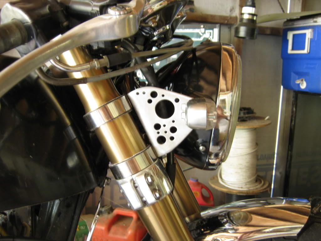

there's somethin about your headlight ears that doesn't sit right with me ...hmmmmm...  i know ...   they're not full o' holes yet  ;D ;D
Is this what you mean Spikey?
*breathes sigh of relief*   AHHHH  ...much better    ;D ;D

I got the headlight brackets drilled and remounted.
The 1 inch hole takes some filing to get perfectly round because the drill bit is so big and the piece is so thin, it makes a sort-of triangular hole at first.

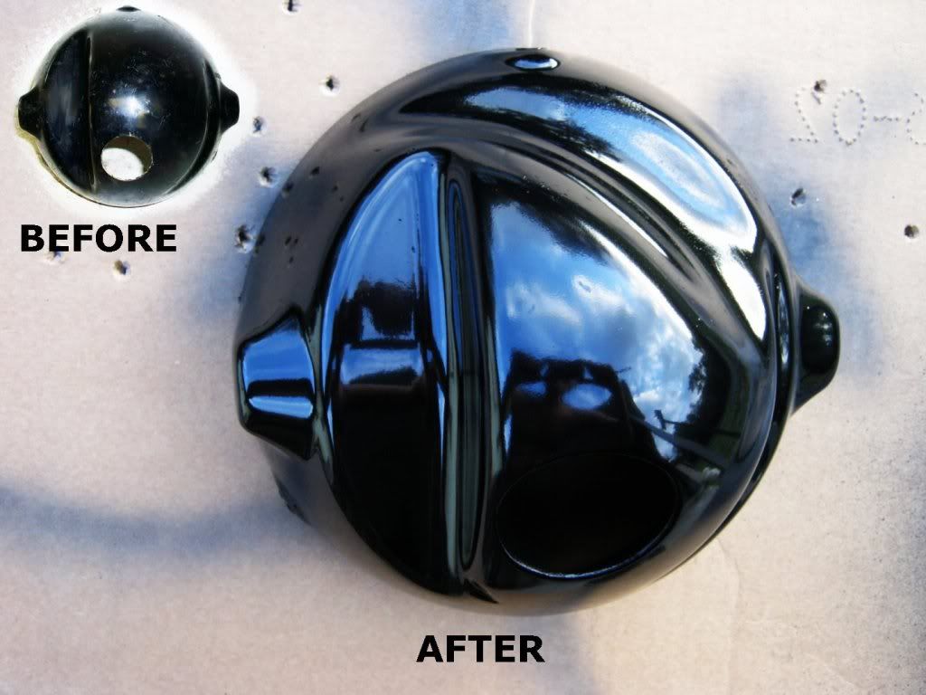

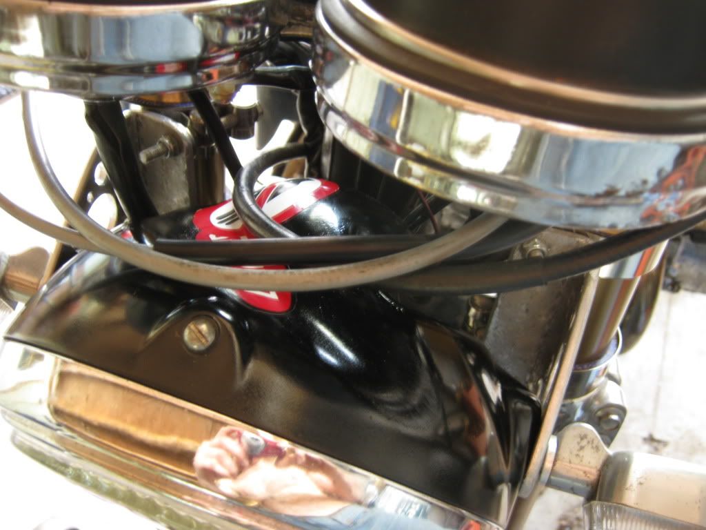

the headlight bucket needed some modification because the clutch cable was rubbing the paint off it,  so I heated it up with torch and rolled it on a 1 inch rod to get a curved shape in it.
 A little paint matching and the lines aren't all cramped up in there anymore.
 (I put some protective stickers on there)
  oh, and I made the wiring hole a lot bigger.
