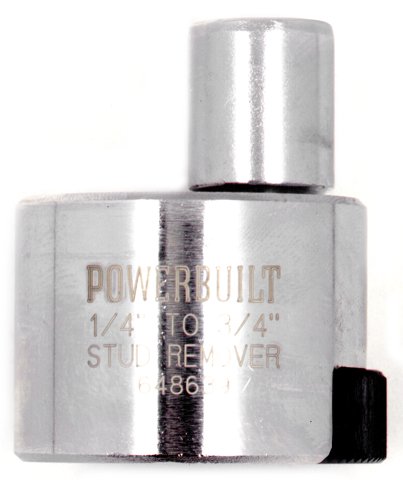

Stud removal - if you decide to do it, get one of these:
http://www.amazon.com/Powerbuilt-648639-Stud-Extractor/dp/B002INQORU/ref=sr_1_6?ie=UTF8&qid=1413405129&sr=8-6&keywords=stud+remover
The upside is that you are far more likely to get a leak-free head gasket for years to come. I can see from the pics that oil was leaking from somewhere in the head (gasket or pucks or maybe both). The stock studs on these engines are thin, as you can see, and they tended to stretch allowing the head gasket to leak. The HD studs are stronger and have a higher torque rating. Much less likely to leak.
The downside is if you break a stud, things get complicated.

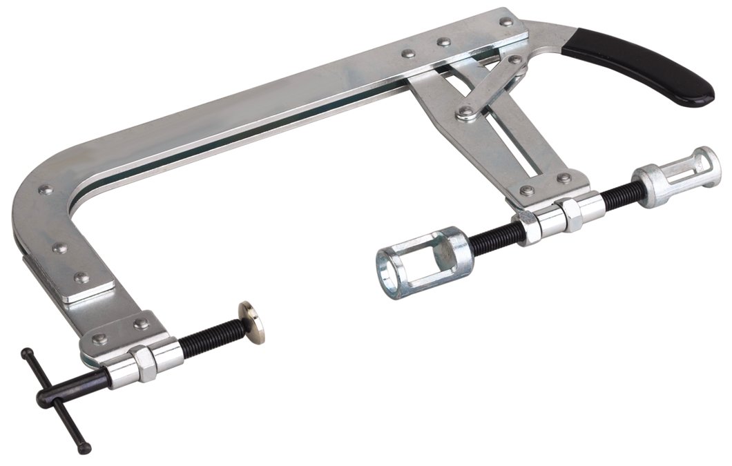

Call around to the auto parts stores in your area and see if they have loaners (valve spring compressor). In my area, there is an Advance Auto Parts store which loans out tools like that. You leave a deposit ($70) and get it back when you return the tool. Since I was rebuilding so many engines, I broke down and bought one. If you strike out on a loaner, this is the one I bought:
http://www.amazon.com/OTC-4572-Large-Spring-Compressor/dp/B000F5ECUY/ref=sr_1_1?ie=UTF8&qid=1413901225&sr=8-1&keywords=valve+spring+compressor.
It works really well on the CB750 head.

We're making some progress.  Got the frame and swing arm painted today.  We still have to wait a couple of hours before it's dry enough to take it back down to the workshop.
We also got the lower part of the head cleaned.  Now I'll go buy that valve spring compressor so we can take the springs off and lap the valves.
