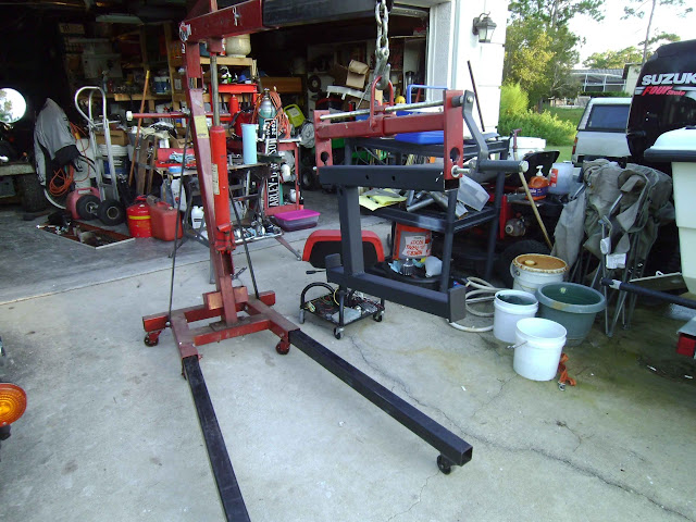

After replacing the coin seals under the cam towers on Friday on my "interim" project, test drove it yesterday only to have the motor continue to belch oil out onto my leg. Took the motor back out today. On a positive note, my homemade C-hook has enabled me to pull an engine from a fully assembled and running bike in just 90 minutes start to finish! A new personal record!
Halfway out!
Mighty tight!
She's out!
What's the sawzall for you ask?
To remove a little extra material! It has since had the rough edges filed off and touch-up paint applied.
Oh I want one of those! :o

« Reply #12296 on: October 14, 2012, 04:58:34 PM »
I can't take full credit, another member posted this design on the forum here somewhere, but I have been unable to find the thread in order to give proper credit where due!
