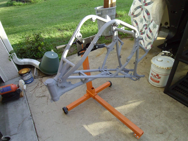

Found two new uses for an engine stand:
To hold a motorcycle frame for priming:
and to hold a motorcycle frame for painting!  :o  ;D
I really appreciate the philosophy behind sending out the frame for sandblasting and painting/powder coating. OMG, after degreasing, washing, scraping, degreasing some more, washing again, more scraping, degreasing, washing, scraping, degreasing, washing, sanding, washing, sanding, and washing... WHEW! Thought I'd never get it ready for prime and paint.
